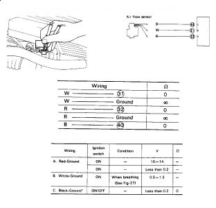

1989 Isuzu Truck 119000 miles
The truck idles rough but runs fine other than that. Dose have a engine code (62) which indacates a broken wire for the mass airflow sensor, my question is dose any one have a schematic for this. I need to repair this wiring issue it has cost me gas milage and much frustration. Thanks in advance.

DAVE H
  • 13,384 POSTS
https://www.2carpros.com/forum/automotive_pictures/266999_isu_2.jpg
+3
Tuesday, April 21st, 2009 AT 5:46 AM
