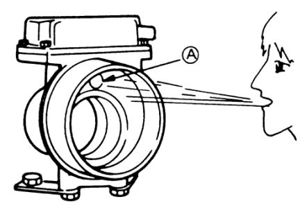

1989 Isuzu Truck 4 cyl Four Wheel Drive Manual
has anyone else had this problem and fixed it???
code 62 broken wire for mass airflow, where could the break be i've rewired and resolderd the connector to the mass but still no luck. also i have traced the wiring all the way back to the computer and still nothing. any advice????

here's how to test mass air flow semsor TESTING See Figure 1
https://images.2carpros.com/forum/automotive_pictures/52960_0900c1528006250b_1.jpg
Fig. 1: Blow through the sampling tube (A) when testing the MAF sensor Uncover the rubber boot on the sensor side of the harness connector. Remove the intake duct from the sensor. With a high impedance voltmeter, check for voltage between the white wire and ground while blowing through the sampling tube in the sensor. Voltage should be between 0.5-1.5 volts. If not, replace the sensor. Turn the ignition OFF. Install the intake dust and recover the connector with the rubber boot.
