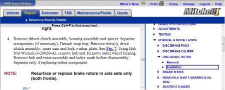

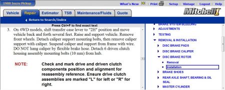

What do I have to remove to replace front rotor on 4WD standard cab PU?
Sep 12, 2009 at 11:29 AM
  • 75,992 POSTS
See below
