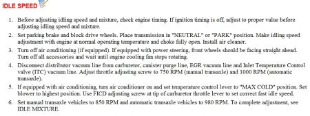

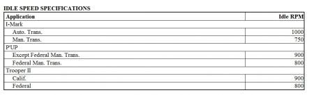

1987 Isuzu Truck idle adjustment
TERISTANAFORD
Engine Performance problem
1987 Isuzu Truck 4 cyl Four Wheel Drive Manual
where is the idle adjustment located, how do i adjust the idle
Apr 17, 2010 at 1:35 PM
BLUELIGHTNIN6
  • 16,542 POSTS
https://images.2carpros.com/forum/automotive_pictures/261618_Noname_2795.jpg
https://images.2carpros.com/forum/automotive_pictures/261618_Noname2_912.jpg
Oct 15, 2010 at 4:43 PM
