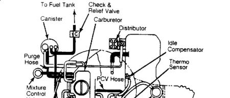

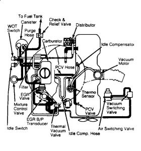

i got all my vac. hoses fixed except the ones on top of the carb. theres 5 fittings on top , all plugged off for some reason what does each fitting go to, except the big one, i know it goes to the charcoal canister, and the fuel line that leaves 3 im stumped on, any advice will be greatly appreciated
[img:2815076f6d]http://www.2carpros.com/forum/automotive_pictures/448830_carb_3.jpg[/img:2815076f6d]
carb # is 8941367610 if it helps

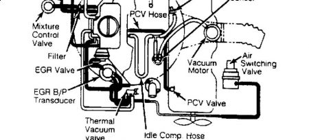

Hi there, Not 100% sure if this is yours, let me know if its not. Mark (mhpautos)

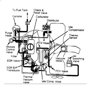

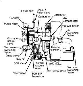

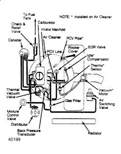

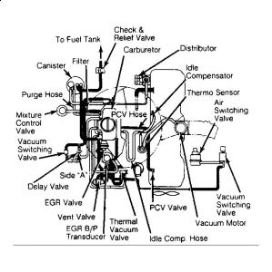

Hi there, here are the 4 variants of the 2.3 engine that i can find, see how this goes. Mark
https://images.2carpros.com/forum/automotive_pictures/61395_Graphic1_13.jpg
https://images.2carpros.com/forum/automotive_pictures/61395_Graphic2_6.jpg
https://images.2carpros.com/forum/automotive_pictures/61395_Graphic3_3.jpg
https://images.2carpros.com/forum/automotive_pictures/61395_Graphic4_1.jpg

hi mark, one of the diagrams you sent me has to be it but there are so many hoses colored black that run together i cant tell where they go. could you please send me a more clearer picture of those 4 diagrams. thanks for helping me out. this is my only means of transportation

If i try and blow them up they go very fuzzy, what i will do is try and do 1 in 2 or 3 parts, now is yours a cal or Federal and is it a trooper or a pick up? sorry about the questions as i am in Australia we call them different names here an i want to get his right .

How is this.
