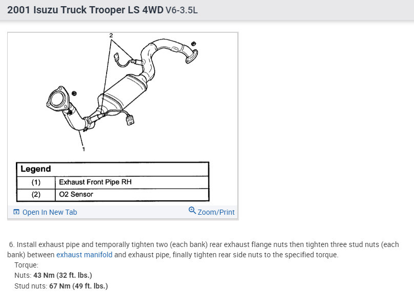

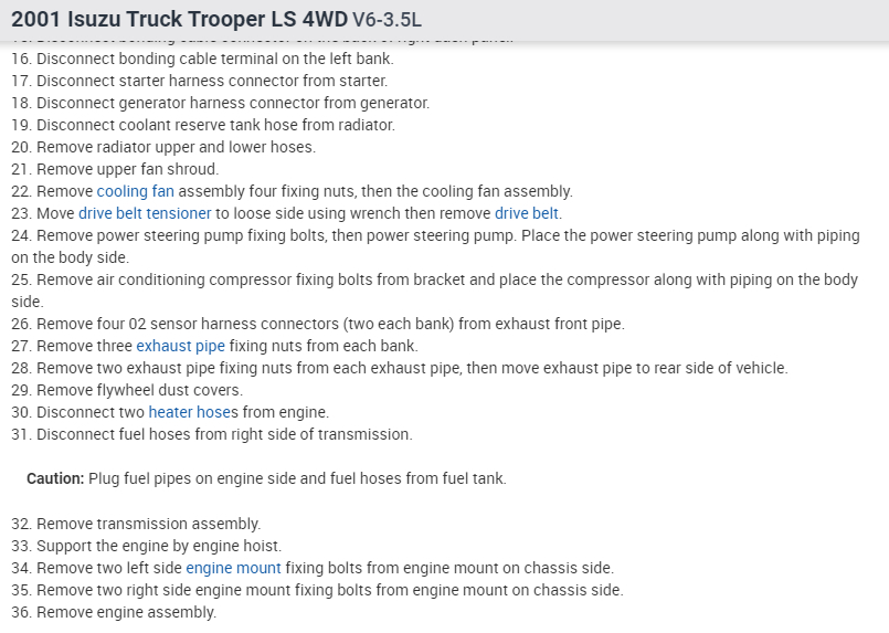

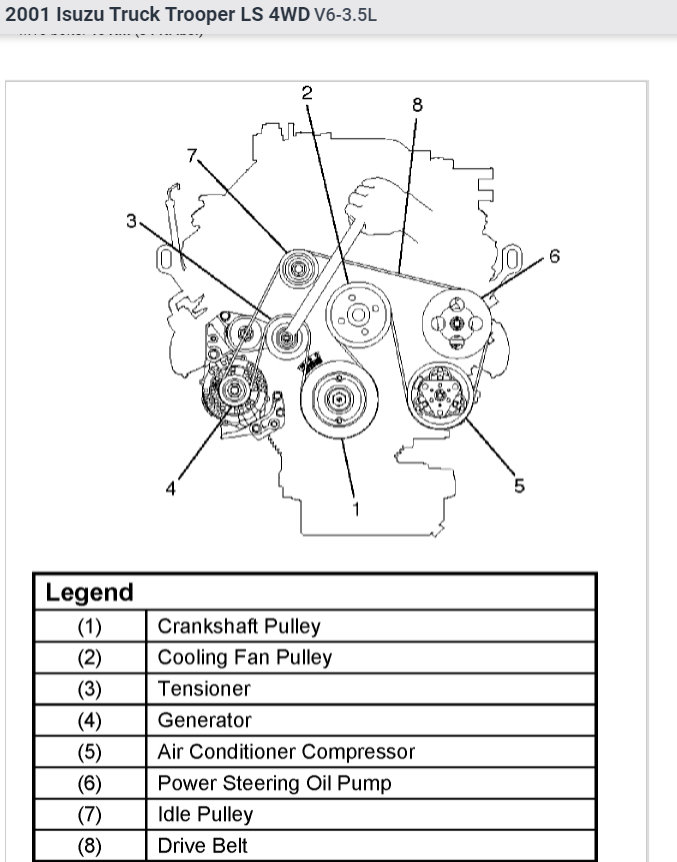

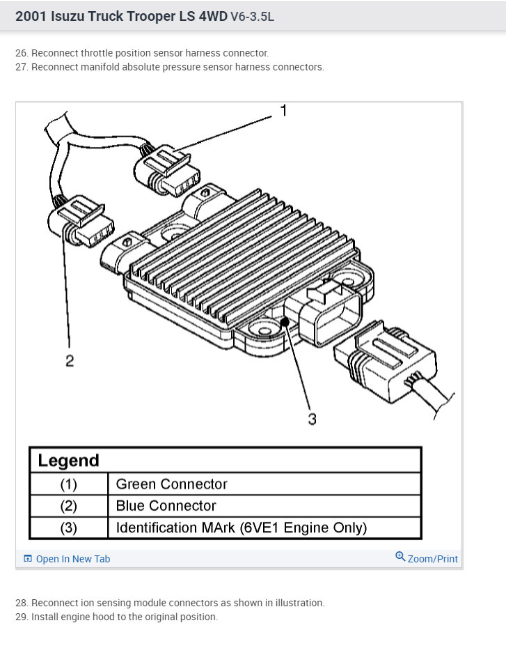

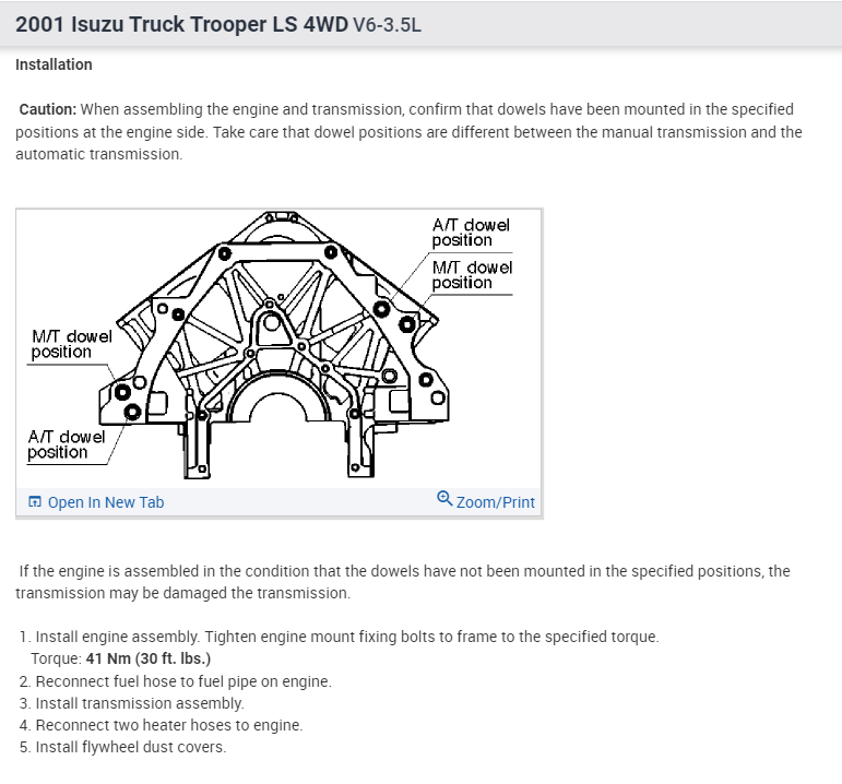

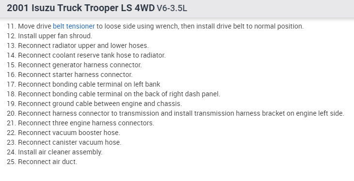

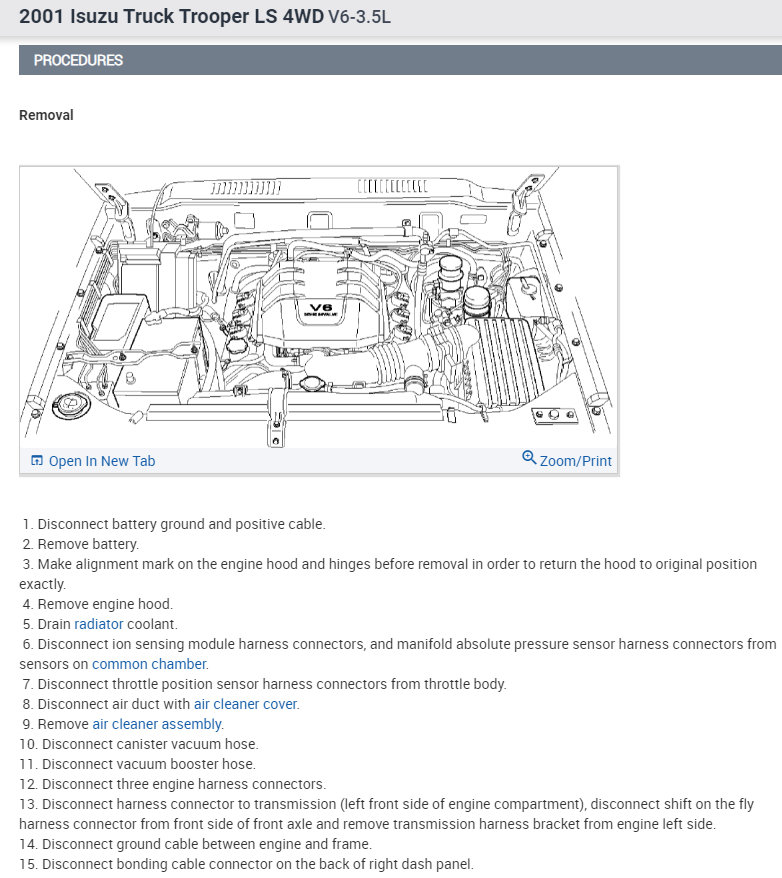

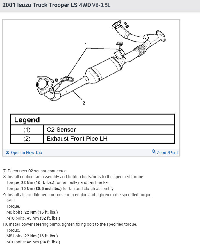

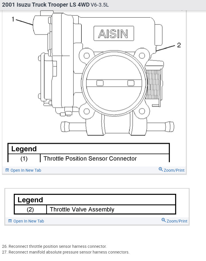

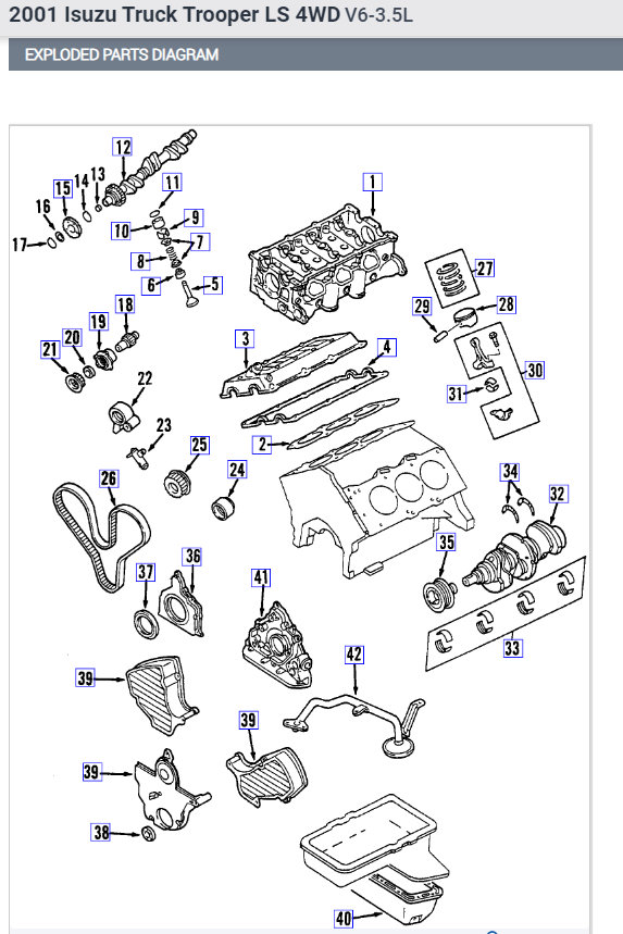

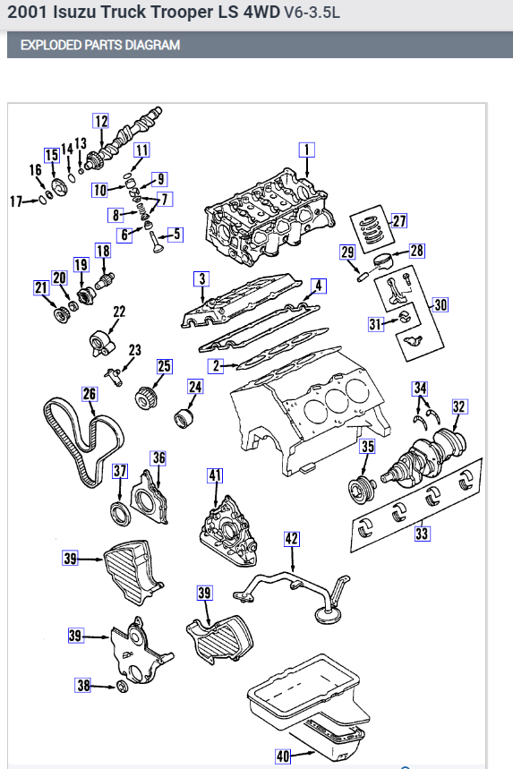

The 4JX1 diesel engine was not offered in the USA.
Unfortunately for that reason we do not have access to the repair manual for that engine.
I have attached the instructions for the 3.5L V6 gas engine, replacement procedure below for anyone might be looking for that information.
