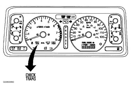

Is the Check Trans light 1. Blinking 2. Staying on 3. Never comes on during initial ignition on 4. Comes on for 2 seconds and goes off after initial ignition On
https://images.2carpros.com/forum/automotive_pictures/192750_CheckTransIsuzu2001_1.jpg
