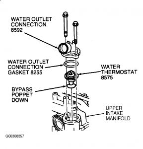

Engine Cooling problem
2001 Isuzu Trooper 6 cyl Two Wheel Drive Automatic
how to change thermostat? diagram
Mar 7, 2009 at 10:02 AM
MERLIN2021
  • 17,250 POSTS
Sorry I couldnt find a diagram for your truck but follow the upper radiator hose, it will take you to the thermostat housing, remove the 2 bolts and lift, it may be stuck a wee bit, but a tap with a small mallett will free it up, remove old tstat, remove old gasker with a scraper, or razor blade, instal is the reverse, tighten bolts evenly and only snag plus a little extra, these housings tend to crack if overtightened.
https://images.2carpros.com/forum/automotive_pictures/62217_Thermostat46_1.jpg
