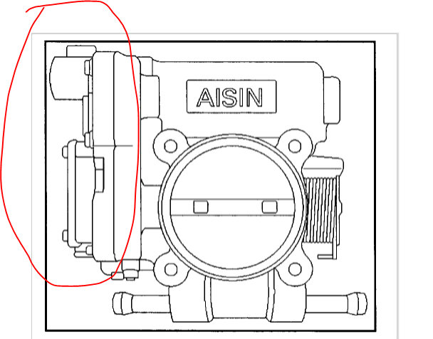

im trying to locate throttle position sensor on my 2000 trooper
Nov 7, 2008 at 7:44 PM
SQM
  • CAR REPAIR CONTRIBUTOR
  • 6,383 POSTS

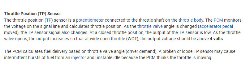

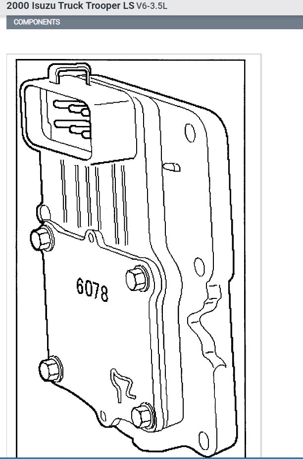

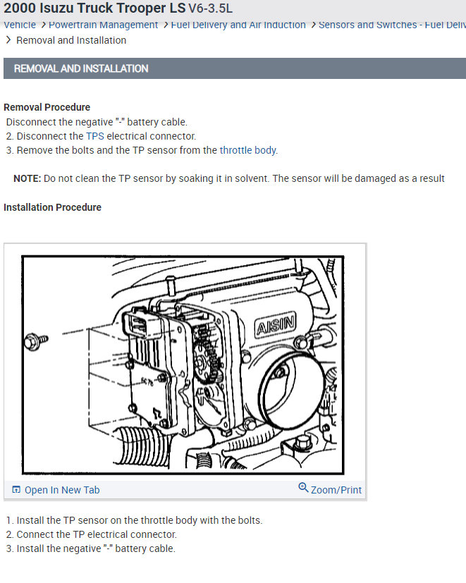

The throttle position sensor mounted on the side of the throttle body (see diagram).
The throttle position (TP) sensor is a potentiometer connected to the throttle shaft on the throttle body. The PCM monitors the the signal and calculates the throttle.
The throttle position sensor you have a output voltage of more than 4 volts.
