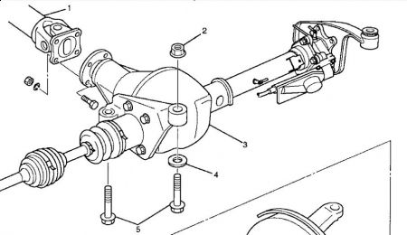

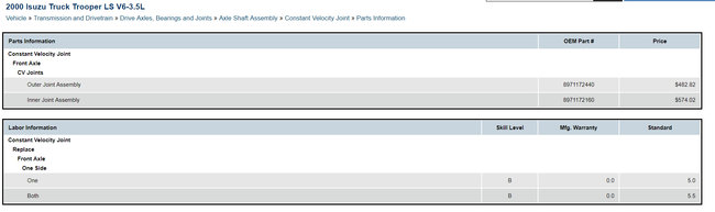

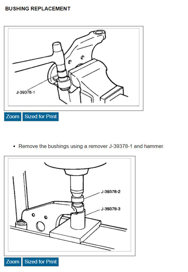

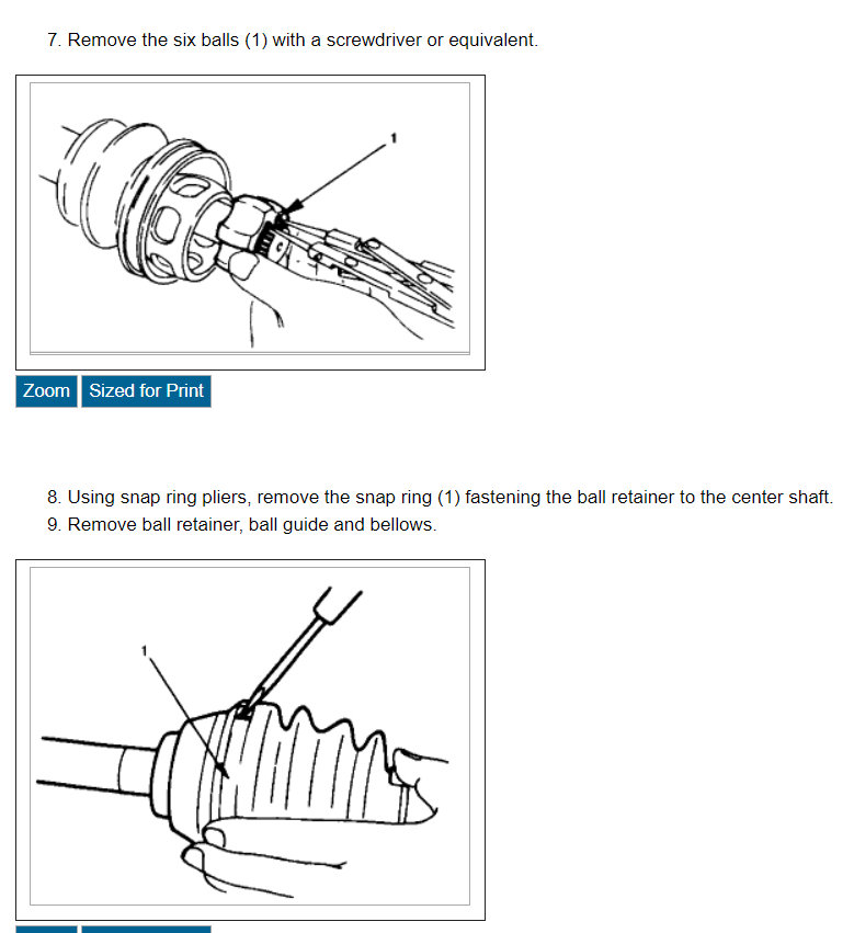

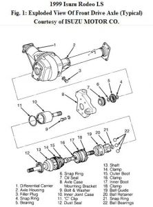

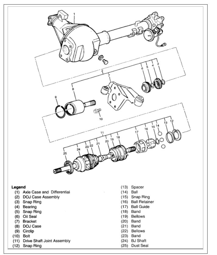

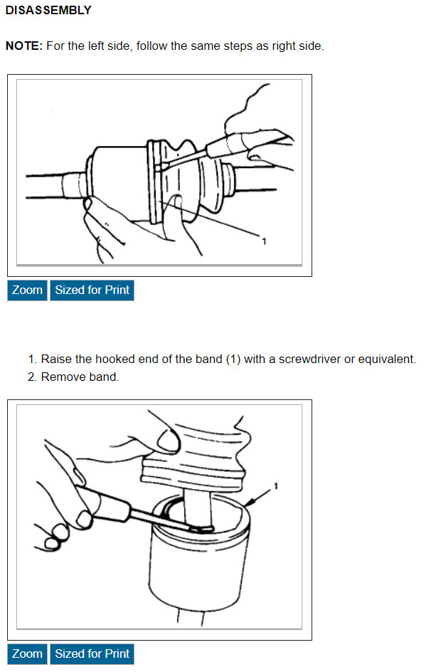

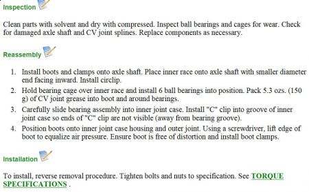

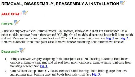

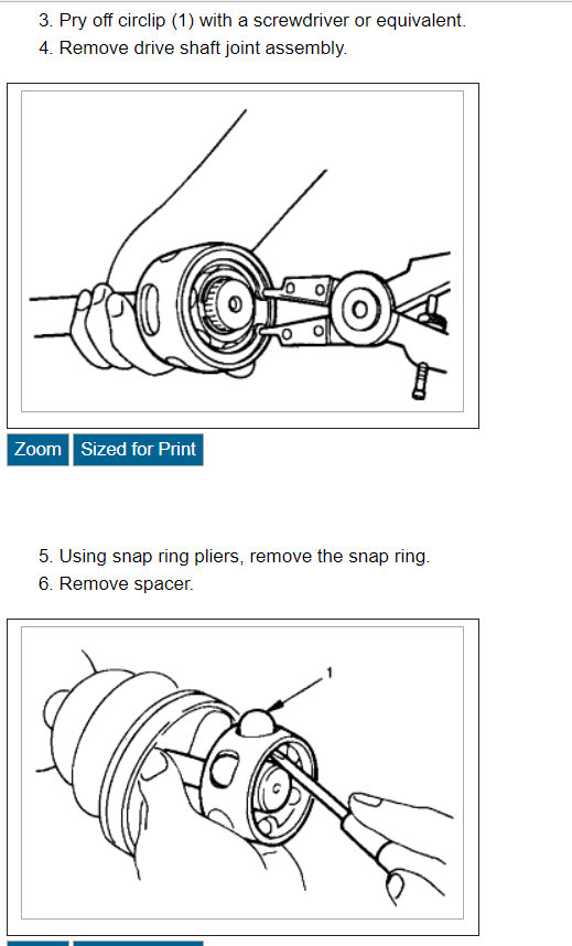

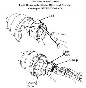

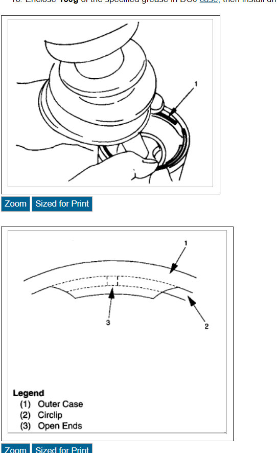

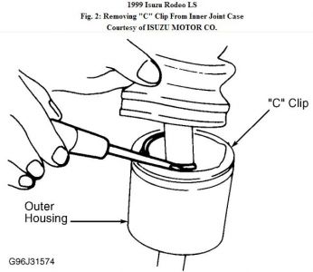

Time to replace on this vehicle. is it similar to front wheel drives,pop support,remove brake cable spindle nut, rotor, pop upper ball joint, tilt spindle, pull outer joint out of spindle,does the shaft w/joints then pop out of inner housings as in 80s era gm,ply. I would like to pull and pop in replace shafts?
Jun 26, 2009 at 5:42 PM
KHLOW2008
  • 41,812 POSTS
Hi ejd742, I am afraid it is not that simple for this model. Outer parts removal are similar but the inner joints are different. The time is 5 hours btw. Here are the removal and installation procedures.
https://images.2carpros.com/forum/automotive_pictures/192750_CVShaftRemoval00Trooper01a_1.jpg
https://images.2carpros.com/forum/automotive_pictures/192750_CVShaftRemoval00Trooper01b_1.jpg
https://images.2carpros.com/forum/automotive_pictures/192750_AxleFront99Rodeo_1.jpg
https://images.2carpros.com/forum/automotive_pictures/192750_CVJointInner99Rodeo_1.jpg
https://images.2carpros.com/forum/automotive_pictures/192750_CVShaftRemoval00TrooperFig03_1.jpg
https://images.2carpros.com/forum/automotive_pictures/192750_AxleFront99Rodeo01_1.jpg
Check out the diagrams (Below) Please let us know what you need. Cheers,
