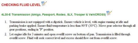

Can you please tell me the location of the dip stick and fluid add resevior for the transmission for my 1999 Isuzu Trooper. Thabk You

https://images.2carpros.com/forum/automotive_pictures/261618_Noname_1335.jpg
