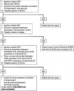

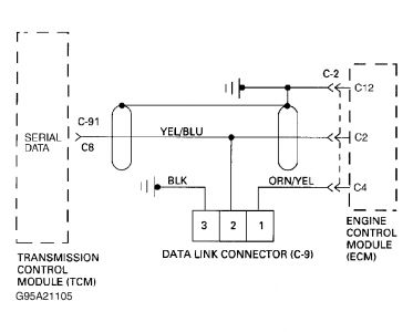

Thanks for the answer. You are very kind.
According to your answer below, I should try and find if something's wrong with the Torque Management Serial Line.
Question: Is there a way to identify this line? Color or something?
Thanks again.
Your answer:
the tranny control module (TCM) is behind the left side of dash, above kick panel.
code 37 : Torque Management Serial Line Faulty
Check wiring to the PCM and TCM. if OK suspect faulty TCM.

use test steps & schematic below with diagnostic scanner (aka Tech 1) to pinpoint the culprit..
https://images.2carpros.com/forum/automotive_pictures/261618_Noname_2264.jpg
https://images.2carpros.com/forum/automotive_pictures/261618_Graphic_543.jpg
