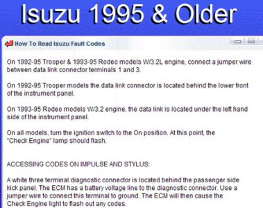

Read your codes before replacing parts...OBDI 02 sensors were good for about 50,000.
https://images.2carpros.com/forum/automotive_pictures/62217_Codesa_2.jpg
