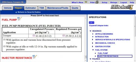

Hey all,
Long story short my fuel pump wasn't bad just the wiring and i figured that out after i broke the bracket for the fuel pump on the top of the tank.
So i am putting in an in-line fuel pump in hopes to save money (from dealer $350).
can you recommend me exactly what i need and the specs?
I need to know what PSI electric pump i need for a 3.2L 94 trooper. and maybe pick one out from a website if you could :)
Thanks
-Noah Moss
Jun 2, 2010 at 10:47 AM
  • 75,992 POSTS
Hi noah360, Welcome to 2carpros and TY for the donation Get a fuel pump that can maintain below fuel pressures with and w/o the pressure regulator
https://images.2carpros.com/forum/automotive_pictures/12900_fp_45.jpg

sweet, thanks, now i just need to know which i need...Do i need the high pressure 40+ psi or 20+psi pump? sorry for earlier, the picture wasn't loading

So just curious, which do i need? The lines are regulated but how you describe it means i need which? sounds funny when i read it back

Sir-you will need an electric fuel pump that can constantly maintain between 25-46psi
