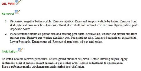

I just recently bought our car from a guy off craigslist and he said nothing was wrong with the car. then we noticed that there was a "ticking" sound that went on and off periodically. Then the oil pressure was dropping to "0" and the car dies. I just needed to know if the oil pan can just be removed or does the engine have to be pulled first to remove the oil pan?
