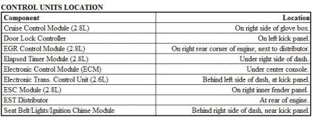

Diagnosed why my 1989 isuzu trooper (4 cyl) won't start down to the ignition control module but how do I find it? Any help would be greatly appreciated.

Hello and thanks for donating! Below is a list of your vehicle's control modules and locations.
https://images.2carpros.com/forum/automotive_pictures/261618_Noname_1704.jpg
