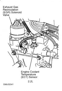

It is at the rear of the engine in the intake manifold near the EGR valve. Here is a pic to help. Now if you ohm it (not the harness) and do this when it is cold and get back to me with the readings and the temp at time I will look it up to see if it is in spec.

Took off that coolant sensor, was not easy. I had a lot of trouble getting the volt meter in there, had to go mostly by feel, but I got a reading of 4.53 at 20k. The car has not been started in over 30 hrs. Temp outside is 64.

Well it is out of range it should be couple of thousand less then it is. I would replace it and see how it does. Let me know how it goes.

It is kind of hard to get back there and see what is going on. Any info on the easiest way to get it out and the new one in? It will probably be this weekend before I can do it.

It might help to get an EGR valve gasket and remove it to gain better access to the coolant temp sensor. That is all I can think of to help make it easier. You have the car so you will have to look to see if that will actually help. Let me know it goes and we will take it from there.

Replaced the coolant temp sensor yesterday. It was actually easier than getting the ohm reading. Truck seems to be behaving better, but still getting jerk and hesitation intermitently this morning. Engine light back on but havn't coded it yet.
I had noticed that from time to time the fan would run/cycle after I stopped. I havn't heard it do that in a while, thought new sensor might get that going again. Hasn't yet. The other one seemed to have needed replacement.
