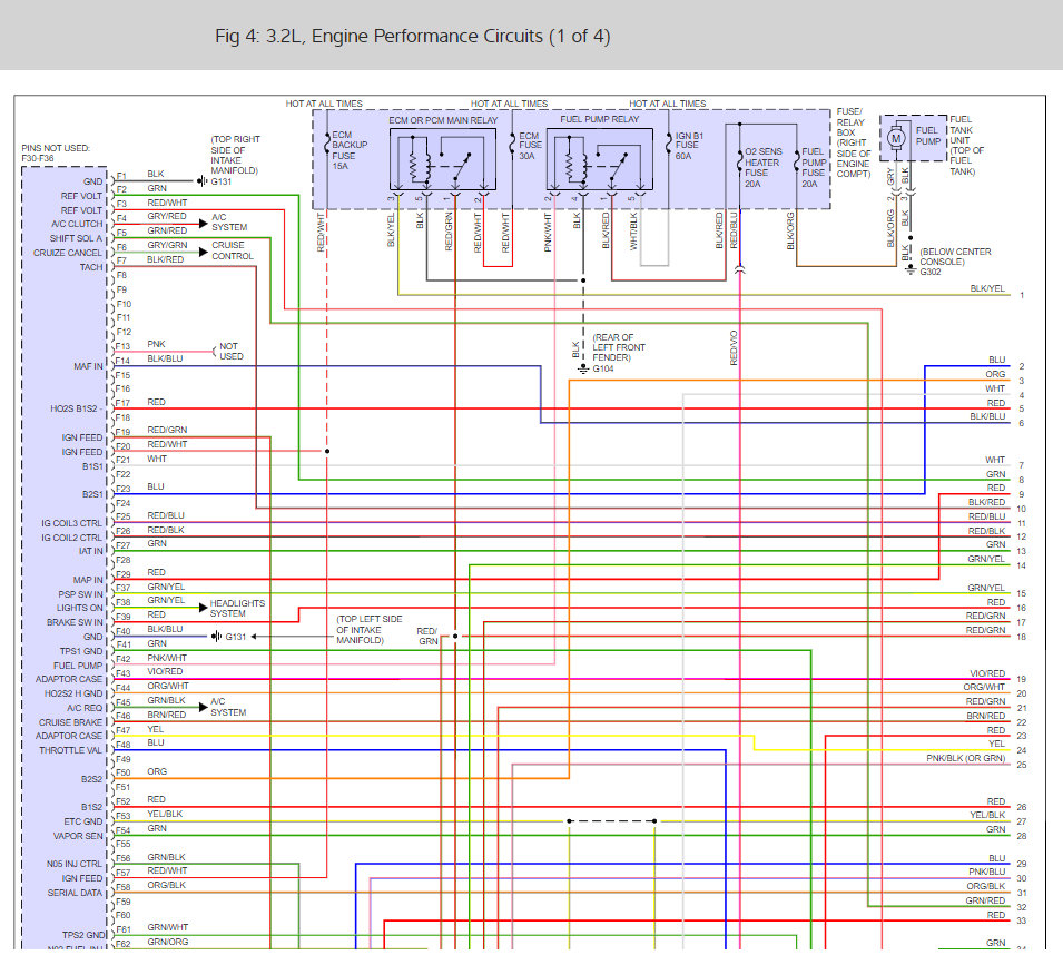

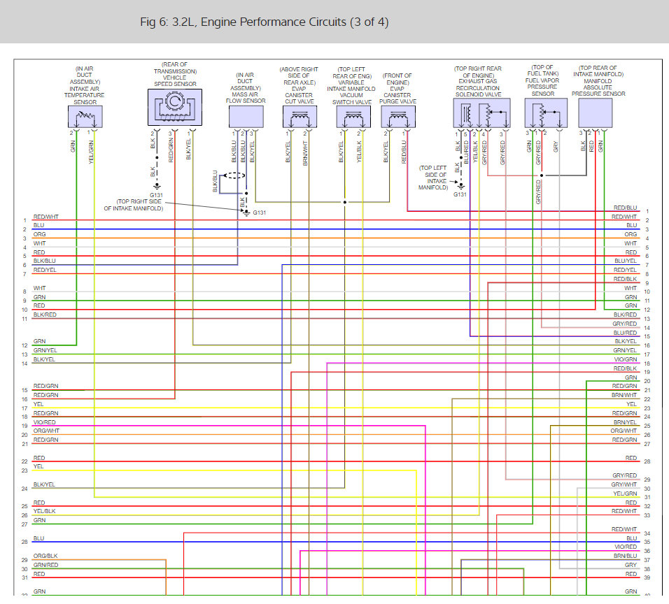

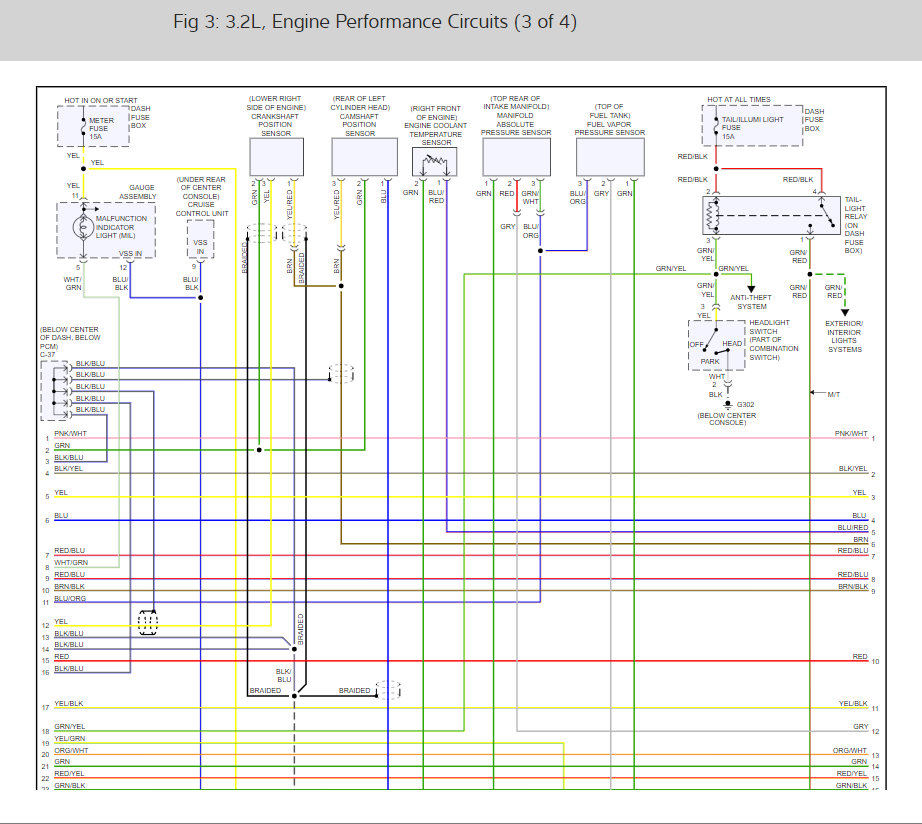

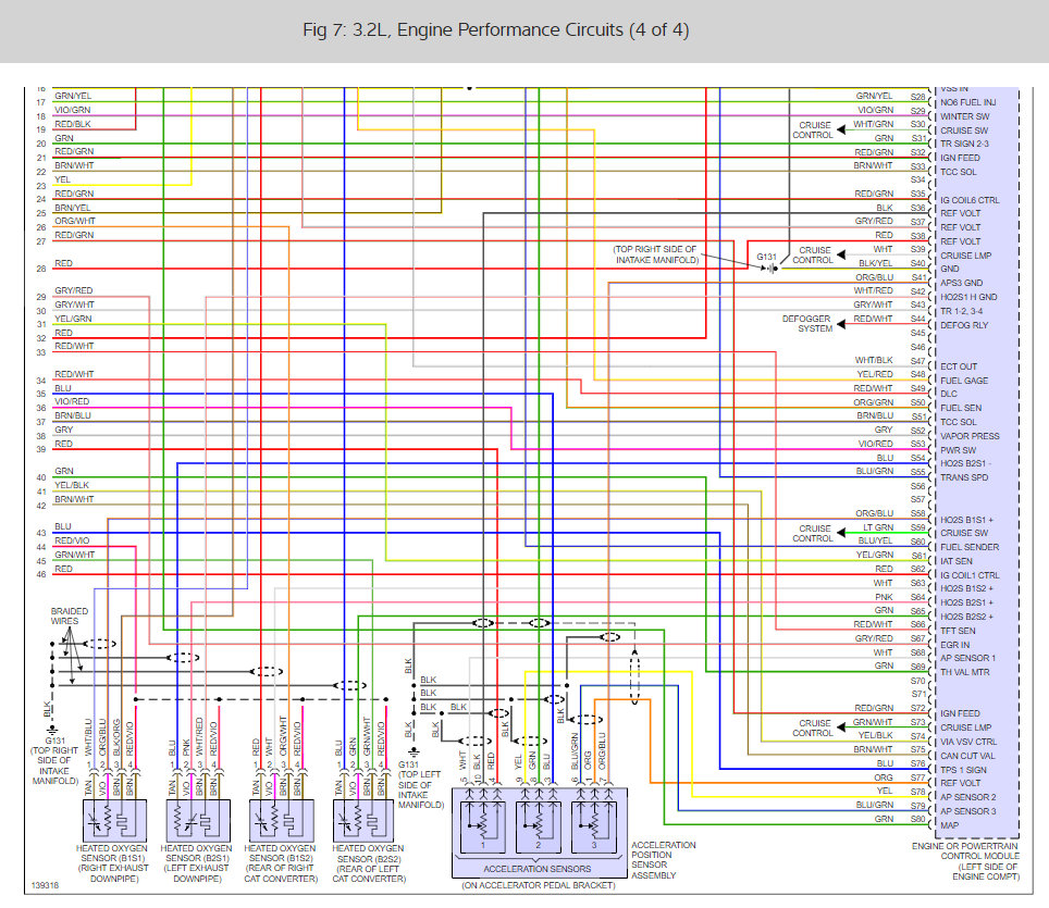

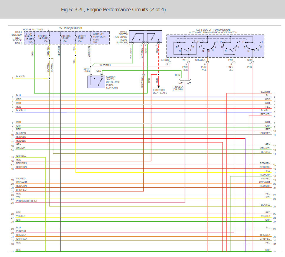

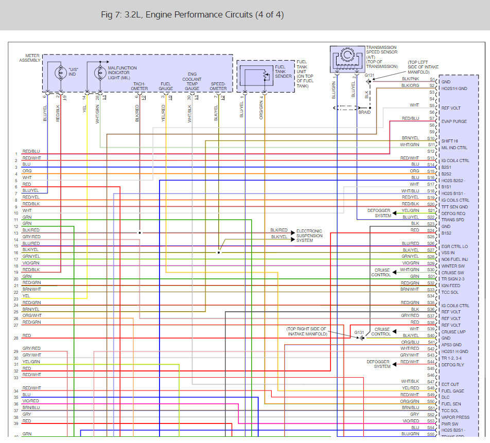

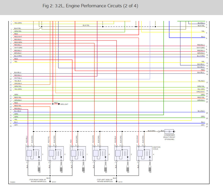

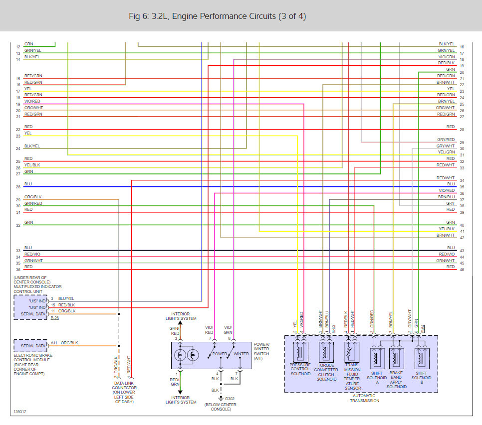

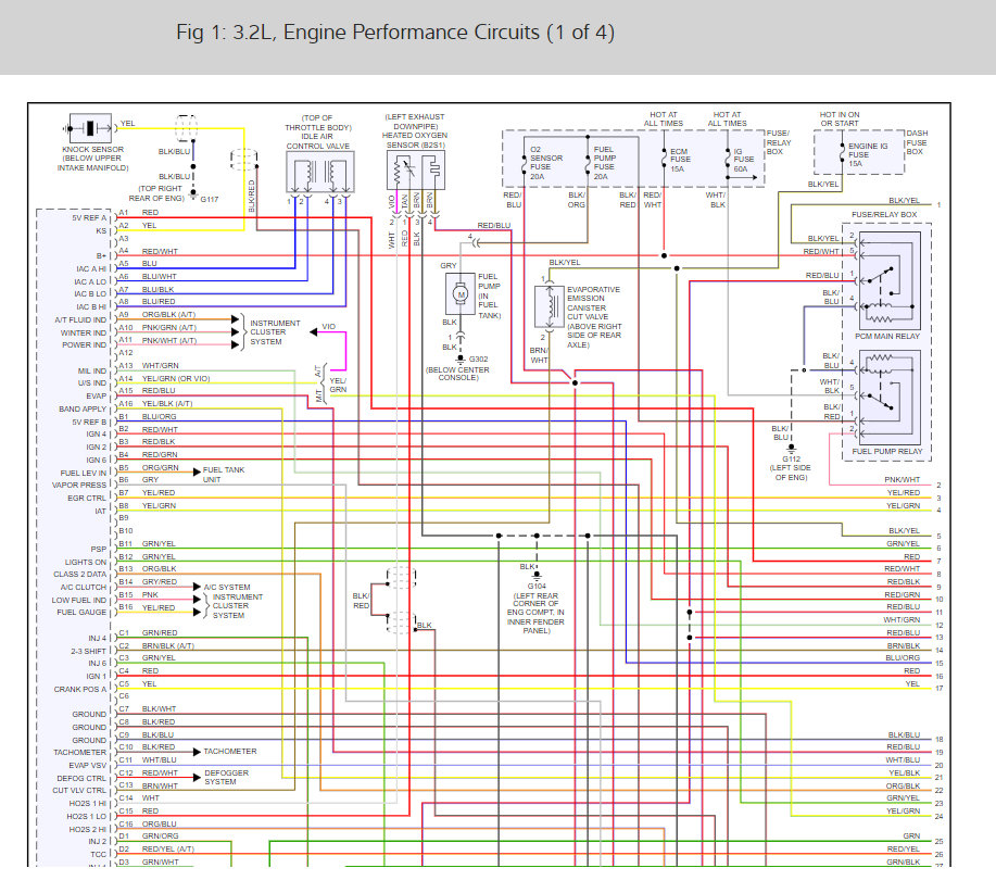

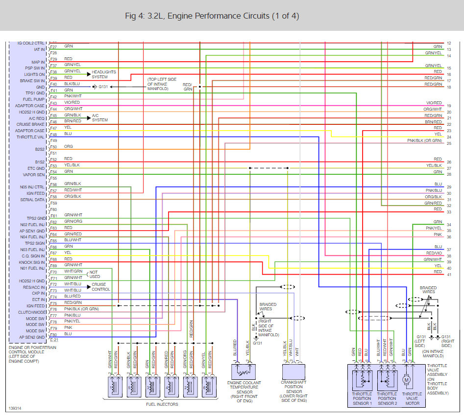

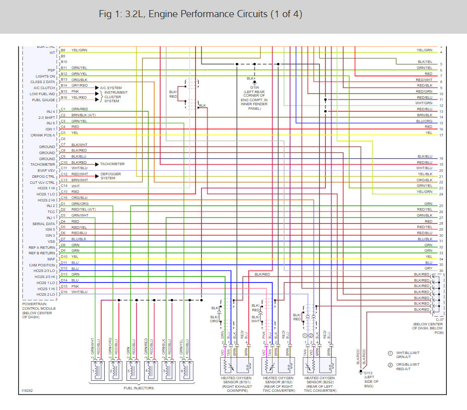

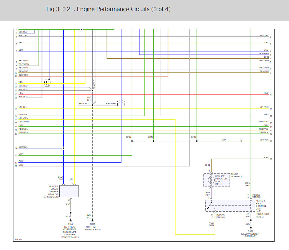

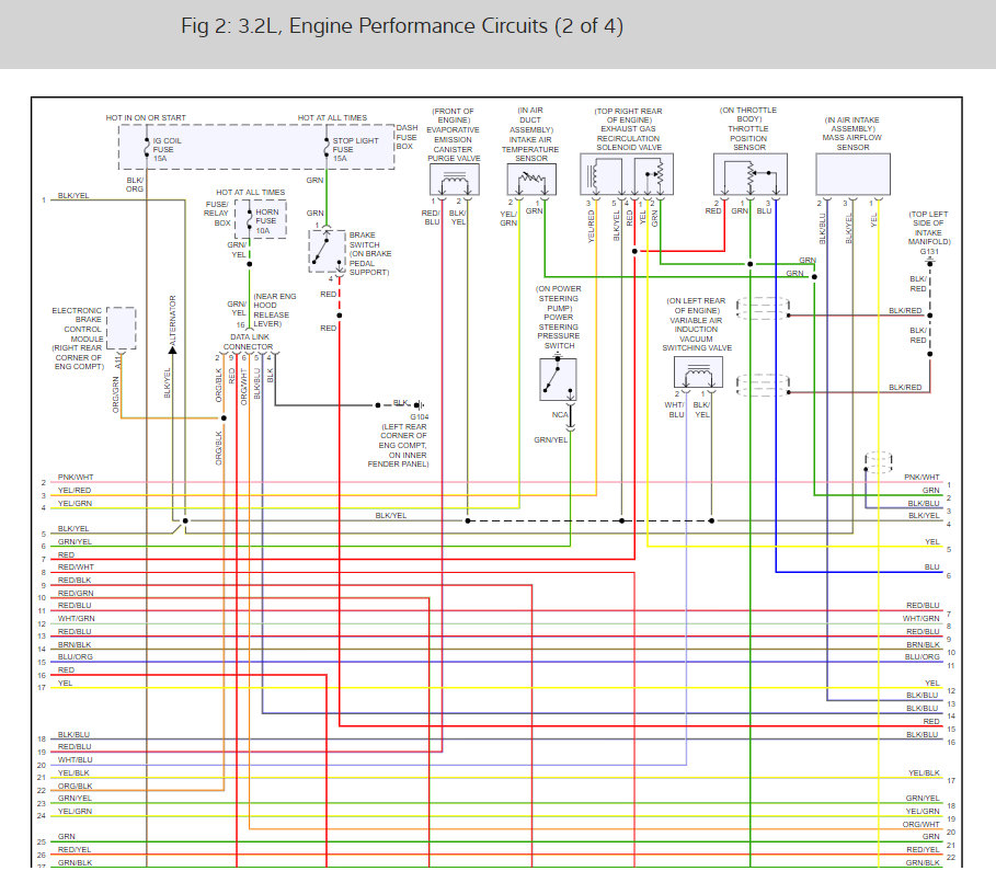

I get a check engine-reduced power lights after engine start. It seems to only happen when temperatures are 40 degrees or lower. The engine surges when idling. It will not go over 20 mph if I try to drive it. I have seen quite a few posts like tbi one but no real solutions. I need to check the engine wiring can you please give me the wiring diagrams? Here are the codes I get:
P1515 TP Sensor to MAF Sensor correlation
P1125 Electronic Throttle Control Limit performance mode.
P1295 Electronic Throttle Control -Power management mode.
I am assuming these codes lead me to several things: Mass Air flow sensor, Throttle position sensor and possibly the EGR Valve. I am not sure what to do or where to go from there.
Nov 8, 2010 at 5:09 AM
SATURNTECH9
  • 30,869 POSTS
Here is a guide to help you with the wiring testing with the engine wiring diagrams below.
Check out the diagrams (Below). Please let us know what you find. We are interested to see what it is.

Thank you for the info! I am working the diagrams right now. I will let you know how it comes out. The engine is a 3.2L.

MTNBIKER
I followed the diagrams..it pointed me to the TPS. I replaced it for about 80 bucks. That did the trick! I'm back up and running. Thank you for the help!!
