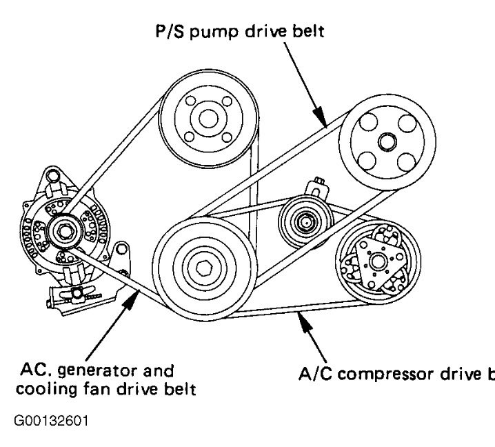

DEBRAC17
Need to find out how to connect fan since there is more than three holes to choose from. need exact diagram of the three belts and sizes, etc.My vehicle is four wheel drive.
Jun 19, 2020 at 5:56 AM (Merged)
HMAC300
  • 48,601 POSTS
we do not have a picture of that. just fit pulley and fan into which holes will line up with fan. See picture for belt diagram.

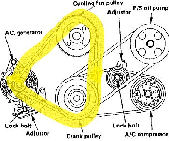

3HAWKS1
My alternator belt got thrown off. There are 3 belts and this just happens to be the very back one. How do I go about getting the 2 front ones off to get to where I can replace this one? What tools will I need? Is there a tensioner (I don't see one) or do I have to loosen the power steering pump,etc. to do this job?
  • 55,691 POSTS
Hello, 3hawks1
You must first loosen the pivot the slider bolts of each accessory, here is a diagram I found for you.
https://www.2carpros.com/diagrams/isuzu/rodeo/1994
You can see each pivot and slider (below)
Please let us know happens so it will help others. If this is not right please down vote and enter in a comment of why it is wrong please.
Best, Ken

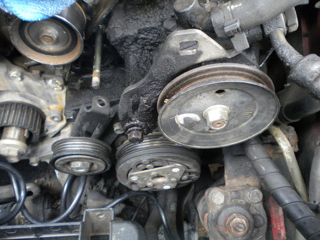

JARRED DINKEL
Where are the bolts to release the power steering pump belt?
Jun 19, 2020 at 5:57 AM (Merged)
  • 110,248 POSTS
Welcome to 2CarPros.
Take a look at the attached picture. If that is the set up you have, there is a slide adjustment on the lower right of the pump that moves when removed. Also, there are two mounting bolts behind the pulley that may or may not have to be loosened for the pump to actually move.
Take a look at pic one to confirm I have the right routing diagram. There are a few for this vehicle. If it is correct, loosen the slide bolt and the two mounting bolts behind the pulley. I have attached a picture of the pump so you can see where the two mount bolts are located. In the picture you can see the threaded holes.

BALDER94
So I have this set up(check image) in my 95 rodeo but can’t seem to loosen the tension to take my drive belt off, where are the bolts to loosen it? I am able to take the other two belts off but can’t get the first one.
  • 110,248 POSTS
I believe there is a bolt in the rear that needs to be loosened. I attached a picture of the pump and circled where I believe it to be. I know there are two bolts behind the pulley that mount it on mount, and I believe there is a third on the rear that does the same, but needs loosened to allow the pump to pivot. You have the tensioner loose.
Let me know if this helps..

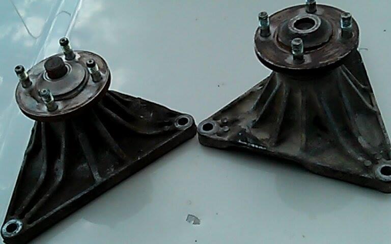

JSTOTT3
After putting in some oil, I forgot to place the cap back. It fell into the fan, and broke the cooling fan blades. I didn't notice anything until the battery light on my dash flashed. After I pulled over, I looked under the hood and realized the damage. The broken fan, isn't the problem (or maybe it is?) but the belt going from fan, to crank, to alternator fell off. I put the belt back on, but noticed that the alternator belt was rubbing on the belt going to the a/c compressor. I can't figure out how to adjust the belt to get them from touching.
Jun 19, 2020 at 5:58 AM (Merged)
  • 110,248 POSTS
Hi:
First, check to make sure the belt is properly routed and make sure the tensioner is working properly. This vehicle has an automatic tensioner and can't be manually adjusted.
Go to this site. It starts with engine timing belt diagrams and at the bottom refers to serp belts.
https://www.2carpros.com/diagrams/isuzu/rodeo/1997
JSTOTT3
This is the Belt Diagram, The it tightens the belt from the adjuster/lock at the bottom of the alternator. I tightened that up, which is when I noticed that the belts were hitting each other. Even with the belt off of the alternator, I can;t find a way to align the belt between the fan pully and the crank below it.
  • 110,248 POSTS
Something has to be out of alignment. Have you checked for any excessive play in the belt driven accessories that could allow the belt to move?
JSTOTT3
Okay, so I figured it out. The fan pulley bolts to a mount. the mount is made up of a plate and a shaft with bearings so that it can spin. When the fan broke, it wobbled the plate that the pulley bolts to, up the shaft. I tried to press the plate back, but it wouldn't move, so I had to get a new pulley mount.
  • 110,248 POSTS
Glad you found the problem. Honestly, I never would have expected that to bend. It's a rigid piece of steel.

SANDRA PALOMINO
how do you put on a new belt please?
HMAC300
  • 48,601 POSTS
see picture move the tension-er in the direction of arrow and that will relieve tension on belt for removal. The tension-er should be replaced at same time of belt however. it may take a socket or just ratchet end to fit in tension-er to move it. See picture.
