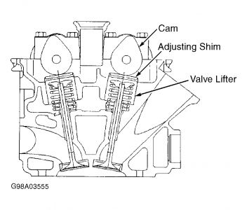

Cyl #1 indicates valve problem Cyl #3 low need wet test to tell if valve or rings Cyl #5 indicates ring fault or piston and wall fault Valve ADJ can cause loww compression set EX .012in. INT .011in. see diagram
https://images.2carpros.com/forum/automotive_pictures/198357_Graphic_700.jpg
Nov 8, 2010 at 3:32 AM
KNUTTY1
  • 11 POSTS
Thanks DocFixit, i should of wet tested cylinder #3 also then, but i will have to retest it. and thanks for your diagram. I'll repost my results when i retest the cylinders again..Hoping to get at the valve cover too so i can at least see the top half..One crazy question; what does a spun bearing sound like?
