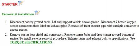

Where is the starter located and how do I replace it? It clicks lots of times before starting. I need very clear instructions. Thank you very much for your help.

The starter is located underneath the engine, on the rear of engine near transmission. Just follow the power cable from the battery down through the engine compartment if you have problem finding the starter, it leads right to it..
https://images.2carpros.com/forum/automotive_pictures/261618_Noname_571.jpg
https://images.2carpros.com/forum/automotive_pictures/261618_Noname2_147.jpg
