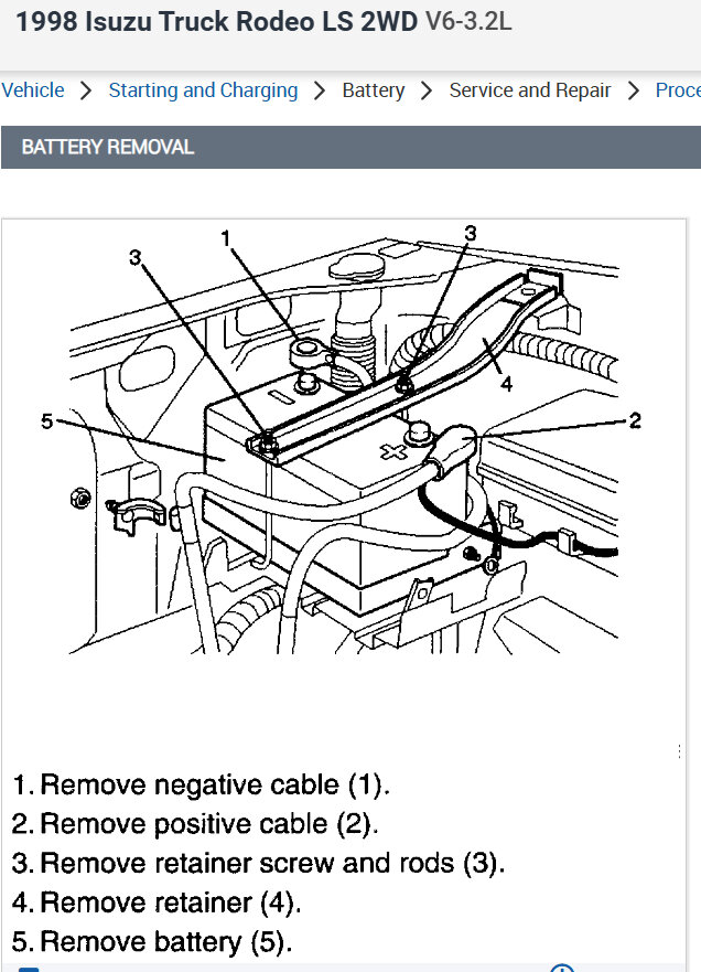

i've been having problems starting my isuzu rodeo. when i turn the key all i hear is a clicking noise. one guy told me that its my starter and that i should hit it w/ a hammer but not too hard... lol. someone else told me that its my battery.

Have your battery tested FOR FREE at the local auto parts store. They will tell you if it is the battery or the starter.

This will be a battery issue. Here is the guide you can load test the battery yourself.
Here is how to change it out for a new one if it fails the test. Check out the images (below). Please let us know what happens.
