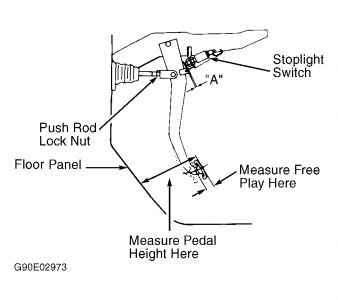

I guarantee that free play at the pedal WAS adjusted this way, But you have a leak somewhere in the system, with 205,000 mile, your calipers need inspection for fluid passing by the seals.
https://www.2carpros.com/forum/automotive_pictures/62217_Freeplay_1.jpg
I believe the dealer adjusted too high and caused the brakes to drag.

Did you read my post? Pedal freeplay is adjusted by adjusting the pushrod, if done wrong SEVERE brake drag WILL occur! This is true for disc and drum brakes!

If there is incorrect freeplay it can not be adjusted at the pedal. It is adjusted with the rod between the booster and the master cylinder. This should have been set by the remanufacturer of the part. Now did they order a booster and master together or seperatly? I would day that one or the other are bad. It don't happen to often but from time to time you get a bad unit from the rebuilder.
