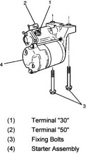

1997 Isuzu Rodeo Question 6 cyl Four Wheel Drive Automatic
How do you remove and replace the starter?

Remove or disconnect the following: Negative battery cable Heated Oxygen (HO 2 S) sensor connectors Exhaust front pipe Heat shield Starter wiring connectors Starter motor To install: Install or connect the following: Starter motor. Tighten the bolts to 30 ft. lbs. (40 Nm). Starter wiring connectors Heat shield Exhaust front pipe Heated Oxygen (HO 2 S) sensor connectors Negative battery cable
