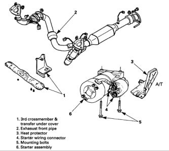

how to remove and reinstall a starter
Dec 30, 2009 at 11:45 PM
  • 75,988 POSTS
Removal Preparation: Battery ground cable 1.3rd crossmember & transfer under cover. 2.Exhaust front pipe. 3.Heat protector. 4.Disconnect the starter wiring connector from terminals "B" and "S". 5.Remove mounting bolts on inside and outside. 6.Remove starter assembly toward the bottom of engine. Installation 1.Starter assembly. Starter Removal
https://images.2carpros.com/forum/automotive_pictures/12900_starter1_24.jpg
2.Torque the starter mounting bolts to 40 Nm (30 ft lbs). 3.Reconnect the starter wiring connectors to terminals "B" and "S". Terminal B And Starter Mounting Bolt Torques
https://images.2carpros.com/forum/automotive_pictures/12900_starter2_1.gif
Torque terminal "B" to 8.5 Nm (73 in lbs). 4.Install heat protector. 5.Torque the exhaust front pipe. Exhaust Pipe Torques
https://images.2carpros.com/forum/automotive_pictures/12900_starter3_1.gif
Nuts 67 Nm (49 ft lbs). Bolts and Nuts 27 Nm (20 ft lbs) 6.Torque the pre-catalytic converter fixing bolts to 27 Nm (20 ft lbs). 7.Reinstall the 3rd crossmember & transfer under cover. 8 Reconnect the battery ground cable.
