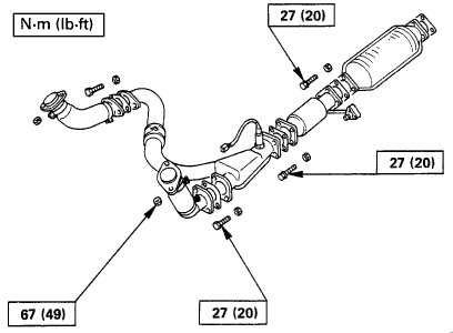

Torque terminal "B" to 8.5 Nm (73 in lbs). 4.Install heat protector. 5.Torque the exhaust front pipe. Exhaust Pipe Torques
https://images.2carpros.com/forum/automotive_pictures/12900_starter3_1.gif
Nuts 67 Nm (49 ft lbs). Bolts and Nuts 27 Nm (20 ft lbs) 6.Torque the pre-catalytic converter fixing bolts to 27 Nm (20 ft lbs). 7.Reinstall the 3rd crossmember & transfer under cover. 8 Reconnect the battery ground cable.
