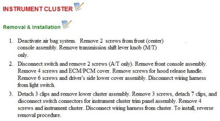

I want to change these bulbs at home. can I get the detailed method how to do it. Thanks.

Mar 16, 2010 at 6:11 PM
