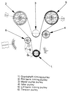

My rodeo seems to run hot and the water disappears and I have changed thermostat 3 times and it still runs hot. I cant understand why it runs so hot. And this has been happening ever since I changed a idel pulley. I followed the steps in the book, can anyone help please.

You have to go back in and recheck the tensioner and idler pulley
https://images.2carpros.com/forum/automotive_pictures/12900_pulley_2.jpg

So you are saying I should redo the idler pulley thing. I have been outside trying to figure out how to flush radiator. Not really sure how yet. But I am running water through the top and its coming out at the bottom, I hope thats right. I dont see how thats flushing, cause it goes from top to bottom quickly. AM I doing something wrong? and what do i need to check about idler? i am not understanding what it is what i need to redo. thanks
p.s. i just took laptop outside and my engine does not look like this picture, very confused now. at the top is a big wheel, them to the right is a little idle pulley, then next is powersteering, then goes to the bottom around a big one then back up to the top. Oh I just figured something out. The pully I changed must not be an idler pully, not sure what it is called. but this pulley has a screw that adjusts it up and down, to tighten and loosen, and right next to the power steering pump to the left, Is that the idler pully, and my engine is a sohc.

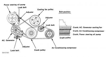

Try adjusting the alternator tension the cooling fan could be slipping What do you meant by putting water on top and its coming out of the bottom-is it from the radiator-explain
https://images.2carpros.com/forum/automotive_pictures/12900_alty_79.jpg

yes i was putting water in top of radiator and it comes out at the bottom, i went and bought a haynes rodeo book and the thing i changed was adjustable idler pulley. and the picture you sent first is behind all the stuff in the front, the picture you just sent is what i am seeing. the adjustable idler pulley is what i changed because it kept squealing making loud noises. the parts house didnt give me one identical to mine but i got it to work. tomorrow I am gonna take radiator out and pray i dont mess nothing up. I am so glad I found this book and some help. Thanks
