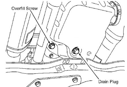

ok im 17 and i have no clue what im doing when it comes to this stuff.....but im trying to figure out how to change my transmission fluid......and i cant fid the dipstick and where to put in new transmission fluid.

The dipstick tube is where you'll put the fluid...on most of them..not yours. There are two holes with plugs on the bottom of the tranny.
https://images.2carpros.com/forum/automotive_pictures/30961_ia_1.jpg
After draining, you refill the transmision through the fill hole. Temperature, volume and fluid type and the rest of the procedure is in the manual.
