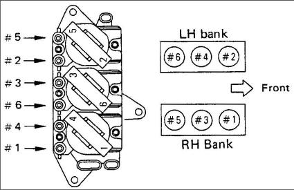

what is the firing order

For the 3.2 my info shows the firing order to be 123456.
