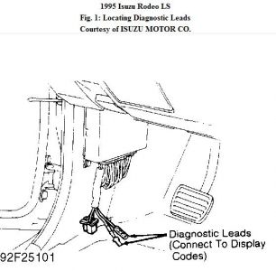

Thanks for your reply, but I looked at the info for getting codes and it seems that the equipment for that is only for 1996 and newer; mine is a 1995. Can I still get the codes?
Jan 6, 2008 at 12:50 PM
FISHERMAN
  • 937 POSTS
Hello !!
Some vehicles start with the OBD II port on 1995
Check your car if it is equiped with the port
Should be located under the steering wheel.
let me know if has it ..
Jan 6, 2008 at 12:59 PM

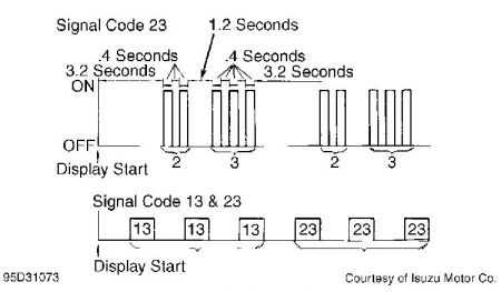

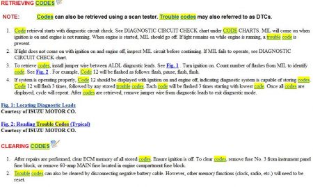

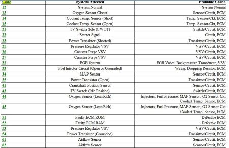

FISHERMAN
  • 937 POSTS
Hello ! Here is how to retrieve the codes and the codes:
https://images.2carpros.com/forum/automotive_pictures/576_rodeo_95_1.jpg
https://images.2carpros.com/forum/automotive_pictures/576_rodeo_951_1.jpg
https://images.2carpros.com/forum/automotive_pictures/576_rodeo_952_1.jpg
https://images.2carpros.com/forum/automotive_pictures/576_rodeo_953_1.jpg
Let Me know on the codes you get! good Luck!
