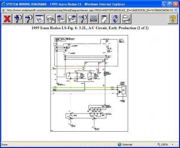

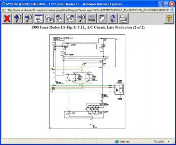

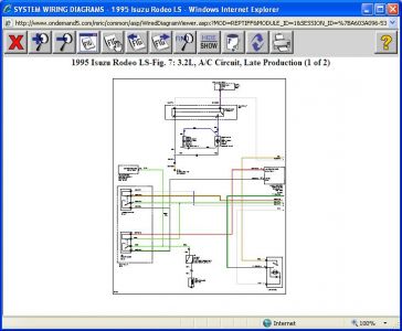

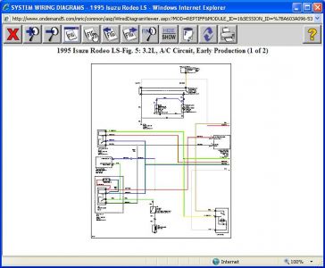

OK, so here is the deal. I have just lost power to my blower motor about a month ago now. i bought a new motor that does work, but when pluging it in, it doesn't turn on. i have already checked the relay's, the fuses, the resistor pack, and the voltage going through the wires. the only problem that i can see is that the connection to the motor doesn't get power. it is only 2 wires, 1 is coming from the resistor pack, and 1 i am guessing is the ground. i have also cleaned all connections to ensure that current will pass through. please help. i really do not want to pay to take it to the shop. thank you

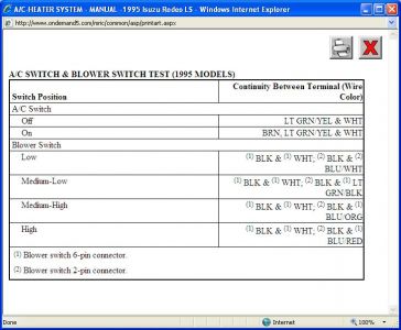

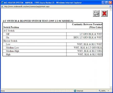

So if you unplug the blower motor and test for power and ground to your terminal connector ends that make contact with your blower motor connector ends is there any power and ground there?On the power side the voltage should increase as you increase the speed of the blow motor switch till you get full battery voltage on high postion.The ground side should just be ground all the time.Let me know what you find.

https://images.2carpros.com/forum/automotive_pictures/416332_1995_isuzu_rodeo_blower_switch_test_1.jpg
https://images.2carpros.com/forum/automotive_pictures/416332_19955_isuzu_rodeo_blower_switch_test_1.jpg
https://images.2carpros.com/forum/automotive_pictures/416332_1995__32L_isuzu_rodeo_LS_ac_circuit_early_production_part_1_1.jpg
https://images.2carpros.com/forum/automotive_pictures/416332_1995__32L_isuzu_rodeo_LS_ac_circuit_early_production_part_2_1.jpg
https://images.2carpros.com/forum/automotive_pictures/416332_1995__32L_isuzu_rodeo_LS_ac_circuit_late_production_part_1_1.jpg
https://images.2carpros.com/forum/automotive_pictures/416332_1995__32L_isuzu_rodeo_LS_ac_circuit_late_production_part_2_1.jpg
Your rodeo has two different a/c blower circuits for that year.A early one and a late production one i posted both for you to follow.I think you have later one since your production date is 07/95 Just look both wire diagrams over to find out which one is yours then you can use the correct switch test for your blower motor.Let me know what you find.
