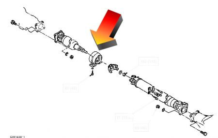

Take a good look at the carrier bearing for play or sag:
https://images.2carpros.com/forum/automotive_pictures/30961_izu_2.jpg

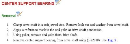

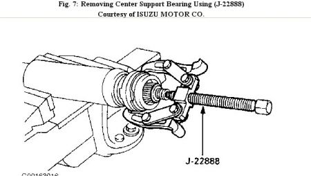

The webbing in the carrier bearing should be reletively stiff. IF it is on the sloppy side that is probably the source, but keep in mind there are many potential sources, this being more common. You may see tears in the webbing as well. You don't need a lift, but will need a puller.
https://images.2carpros.com/forum/automotive_pictures/30961_izu1_1.jpg
https://images.2carpros.com/forum/automotive_pictures/30961_izu2_1.jpg

It looks like I have only a carrier bearing about half way back on the axle. I was looking for one up near the transmission like the diagram shows, but there isn't one.
So anyway, I'm not sure exactly what the check procedure is. Am I supposed to grap the axle and wiggle it to see if there is play? If that's the case then yes there is some play, but I would have thought that was natural to absorbe some shock. I can easily wiggle it though. The rubber is in tact.

Getting clear and accurate diagrams and info is always a challenge in this industry....It really goes beyond imagaination. I am just showing what info I have.
On the carrier, yes it should absorb shock and should be somwhat stiff. It may become a judgement call. Get a good feel for hoe it is and stop and the parts store and evaluate how much stiffer the new one is versus yours. Not any different than shock absorbers, the webbing gets weak over time. How weak to make an issue can come down to opinion.

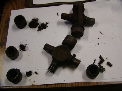

I think I would have the drive shaft checked for balance and while it is out check the u-joints for stiffness.
https://images.2carpros.com/forum/automotive_pictures/30961_ujPA240003_2.jpg
IF you see any rust dust around the caps of the u-joints, you may find they look like this inside.
