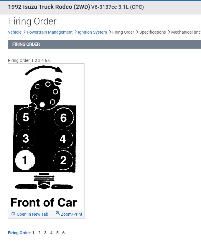

Whats the firing order and which way do I go, clock wise or counter clock wise?

The firing order for this vehicle is 1-2-3-4-5-6
The number 1 cylinder is on the front left (if you are facing the engine).
It is a clockwise rotation.
I have attached diagram for your reference.
