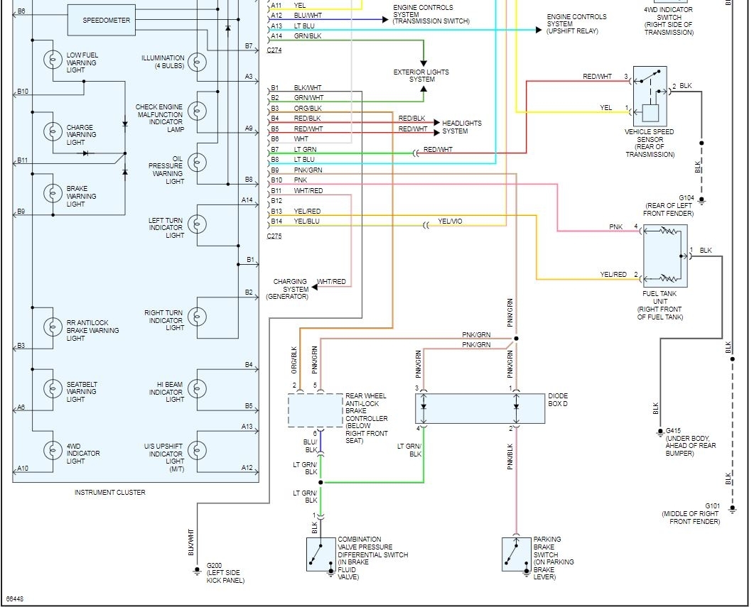

speedometer on a 1994 Isuzu Rodeo
1994 ISUZU
YCATS
I have a 94 Isuzu xls V6, the speedometer went down to zero, then later on it went back up. Why is this happening? Can a speedometer be fixed. I was told it could not be fixed. Thank you for your help.
Nov 10, 2007 at 3:02 PM
SERVICE WRITER
  • 9,123 POSTS

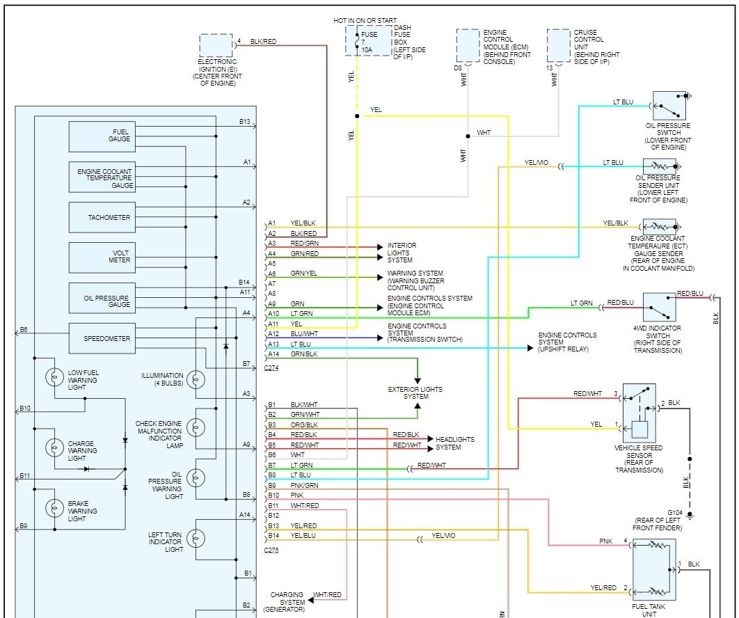

Anything is repairable.
Sounds like it may have a (vehicle speed sensor) VSS for the speedometer going bad or has a bad connection.
The sensor may set a code in the PCM that help lead to diagnosing this.
IF you have a DVOM, it can be tested and I can provide some info regarding that if you like.
Nov 10, 2007 at 9:35 PM
JCOS
could be a bad speedometer cable
