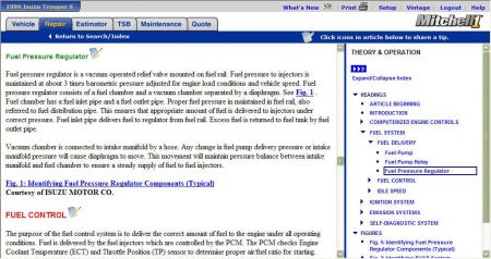

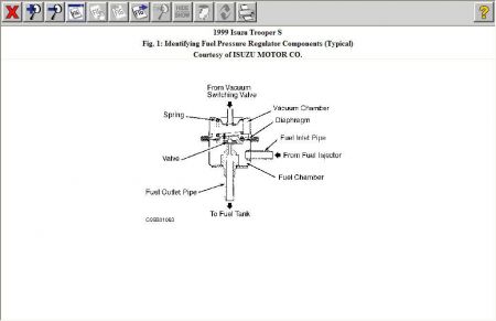

So,the guys at the garage have never put an FPR on a trooper before & they were wondering if anyone can tell me where the FPR is located,just to speed things up in case I do need the part.They were thinking that it may be on the fuel pump & were not to happy about that.
Thanks!!!!! :D
Sep 21, 2007 at 5:59 AM
  • 75,992 POSTS
Its on the fuel rail
https://images.2carpros.com/forum/automotive_pictures/12900_Isuzu_FPR_1_1.jpg
https://images.2carpros.com/forum/automotive_pictures/12900_Isuzu_FPR_1.jpg
