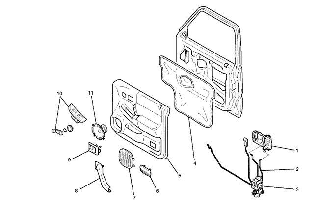

My 1999 Isuzu Rodeo's driver side front door wont open from the outside. I had recently slammed it a little too hard and now the door handle lifts up but the door doesnt open. It works from the inside. I was wondering what the problem was and if I can fix it myself.
Feb 26, 2007 at 12:56 AM
  • 54,840 POSTS

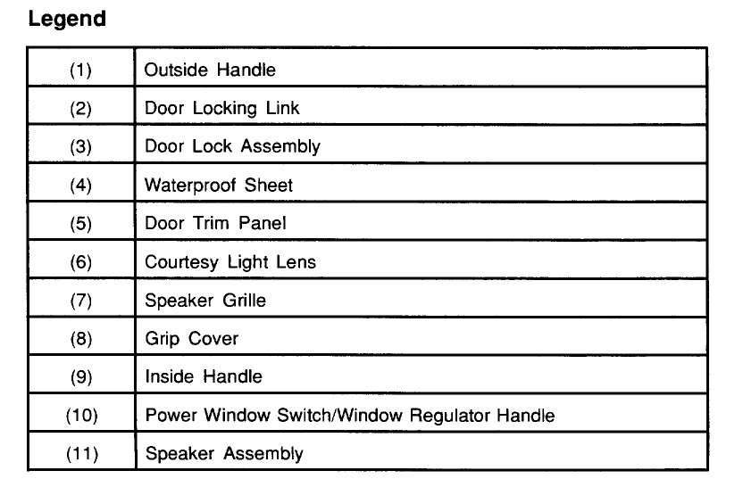

It sounds like you have a control rod that has fallen off becasue the retainer clip has broken. Here are some guides and diagram (Below) to help you take it apart and get the problem fixed.
https://www.2carpros.com/articles/door-panel-removal
and
https://www.2carpros.com/articles/test-or-change-electric-power-door-locks
