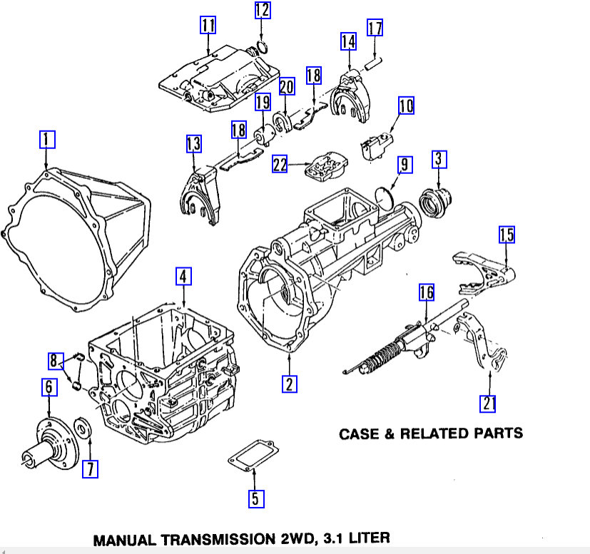

I have same problem. Diagram help please. Or my process please.?

Here is a diagram of what I believe he is talking about. #12 This is an old thread so I hope he comes back and clarifies.

I just had this same problem on my 1998 Isuzu Rodeo, 4-wheel drive, 6 cylinder. What Chaz is talking about is a size 10c washer that has to go on the back-up light switch. I assume this serves two purposes. One is to help seal off the hole and the other is to keep it from going too deep into the transmission. If you install the switch without the washer it will go in too far and thus prevent the linkage from moving far enough over to shift into reverse or 5th. Seems crazy, but in order to test this assumption I unscrewed it about halfway and I was then able to shift into reverse and 5th. It is not necessary to remove this switch when removing the transmission, but I did because I couldn't get it unplugged from the wiring harness so I took it out. I did not notice the washer, but it must have fallen off at some point when I removed the switch. I have attached a picture of the back-up light switch and a picture of the location. This is on the driver's side (left side) of the transmission just below the shifter.
