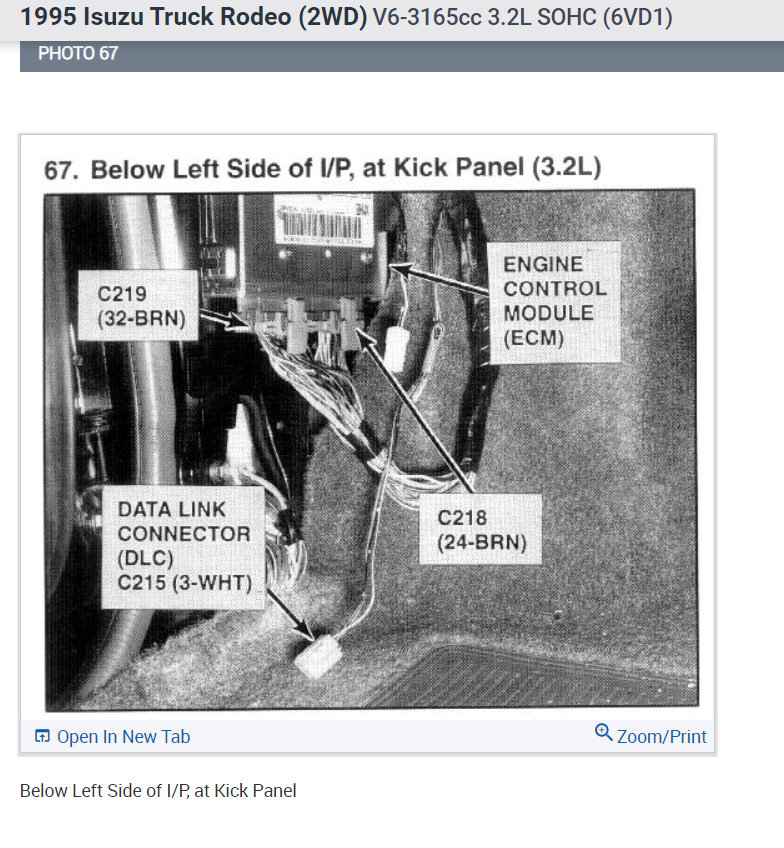

OBD I plug location?
1995 ISUZU
89,000 MILES • 4 CYL • 2WD • MANUAL
RAMON RIVERA
a friend of mine brought me an isuzu rodeo to verify the check engine light that has on all times. ii did not found the obd plug in the car to diagnose why the check engine light is on. can you tell where is this plug located in this car.

Here is a guide to help this car is a OBD1 vehicle and the connector in the diagrams below.
https://www.2carpros.com/articles/odb1-isuzu-1985-1994-cars-and-trucks-code-retrieval-procedure-and-definition
