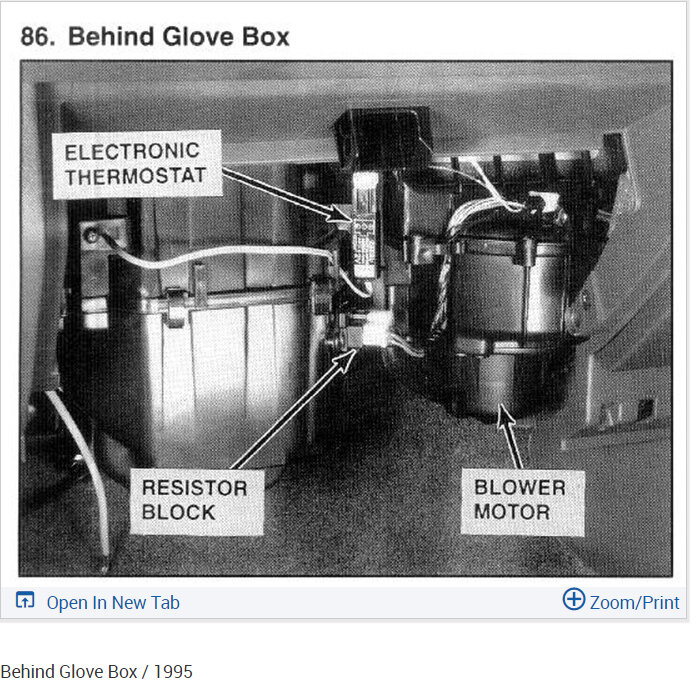

Heater problem
1995 Isuzu V6 Four Wheel Drive Manual 150000 miles
How to remove and replace blower fan on 95 Isuzu Rodeo?
Dec 1, 2007 at 6:07 AM
  • 55,691 POSTS

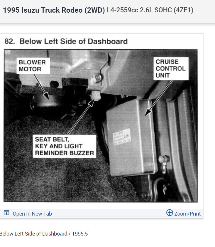

The blower motor is on the passengers side under the glove box, here are the instructions you need to help change it out.
1. Remove floor distribution ducts and glove compartment, as necessary to gain access to motor.
2. Disconnect electrical connector from blower motor.
3. Remove screws securing motor mounting plate to housing.
4. Remove motor assembly. Take care not to damage seal.
5. Remove retaining ring securing impeller, then the impeller.
6. Reverse procedure to install.
Check out the images (below). Let us know if you need anything else.
