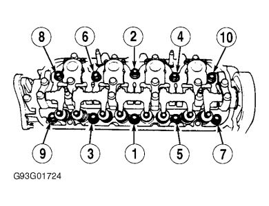

what is torque and sequence of head bolts
Nov 26, 2009 at 10:13 AM
MHPAUTOS
  • CAR REPAIR CONTRIBUTOR
  • 31,937 POSTS
Hi there, Torque down in 3 stages, 29, 51 &72 Ft/Ib
https://images.2carpros.com/forum/automotive_pictures/61395_Graphic_125.jpg
