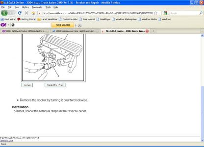

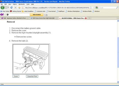

How do you get the cover off to replace one of the bulbs of the high brake light?

First of all thank you so much for your donation.It look's like you pop the cover off then take out two screw's.I posted the instruction's for you to read for yourself.
