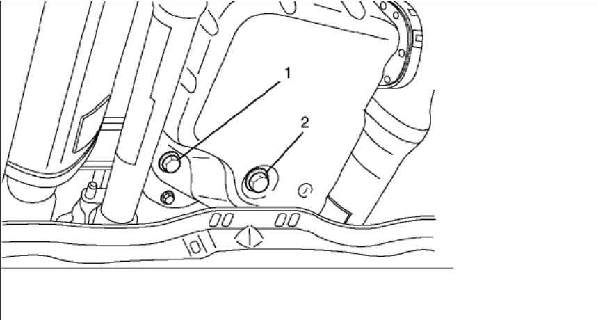

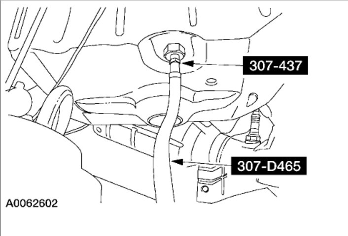

The transmission is slipping. It tends to be much worse when it is cold. When it warms up, it improves. There is no dipstick to check the fluid level. What is the deal with this? How do I check and fill the transmission fluid? Thanks in advance. Any comments would be greatly appreciated.

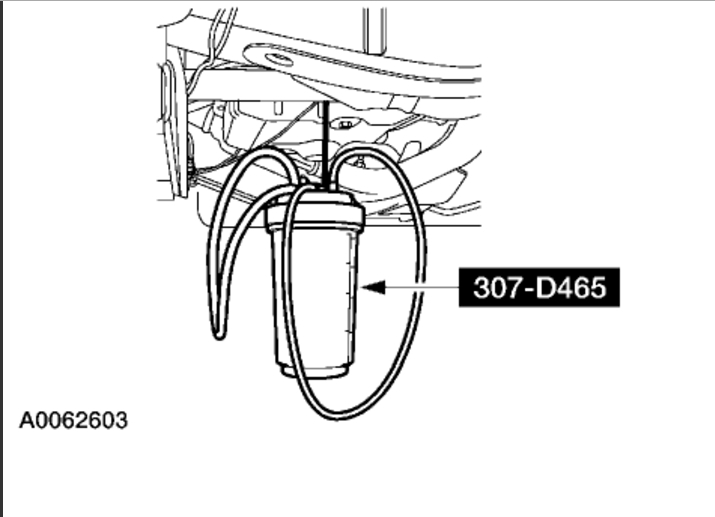

Yes, once the fluid gets low the slip, the funny thing is how you add and check fluid, you just use the plugs on the bottom pump it in until it runs out almost like a stick shift transmission.
Here are some diagram (below) to show you whats up.
I would do a service while you are at it.

Yes, the fluid was low so I did a service and bam! all fixed this site is so great! thanks to all that run it.
