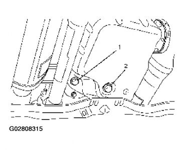

i washed it down and cant find where the leak is coming from. I would like to make sure that i have transmission fluid in it but again cant find where to put it?
Feb 21, 2010 at 2:31 AM
MHPAUTOS
  • 31,937 POSTS
Hi there, There is a fill point on the transmission, see pic, you should warm up the trans and remove plug No 1 this is the over fill plug, the oil should dribble out when plug removed this is also the fill point, Use dextron 111 transmission oil.
