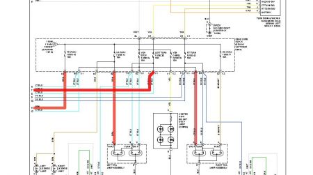

No brake light on rt or lt tail light. I do have on the rear door. I have checked all fuses under hood and under rear seat. also checked the bulbs. im at a loss/ please help. Thanks

Do you have the R/Turn signal ?

Do you have the R/Turn signal ?[/quote:2841b44d06] Yes all other lights work. rt turn also
No brake light on right side and left tail light is this correct?

[quote:8d35f13e2c="rasmataz"]No brake light on rt or lt tail light.
No brake light on right side and left tail light is this correct?[/quote:8d35f13e2c]
That correct, but i do have on the rear door.

Double check the trailer wiring connector for corrosion if okay-the wires between this 2 circuit could open within the wiring harness. With no electrical background this one can be a nightmare for DIY-I strongly recommend you bring it in.
https://images.2carpros.com/forum/automotive_pictures/12900_ascender_1.jpg
