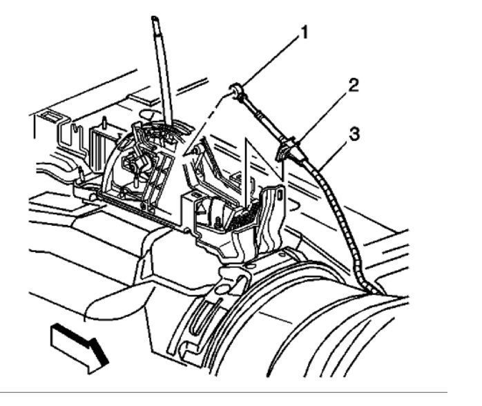

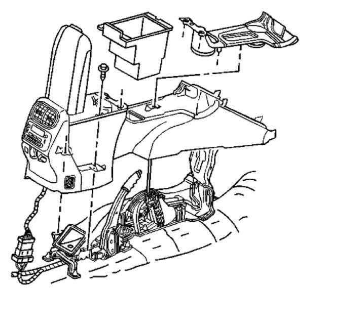

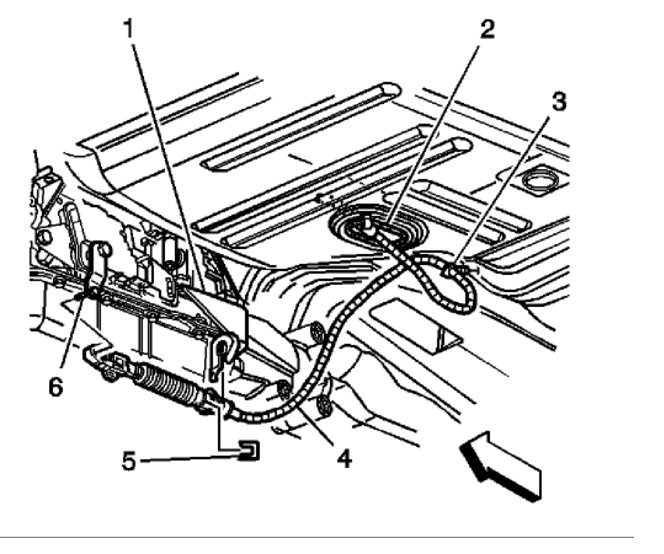

I have a the above mention truck(2005 Isuzu Ascender) and my vehicle slipped into "reverse" when I parked my truck in my garage. It's stuck in "reverse". So I can't put it in "park" or start it. Any answers?
Jul 26, 2010 at 5:58 AM
  • 55,433 POSTS
Hey RODBROWN65,
It sounds like the shift cable is broken which is common. I have included some images that will help you get it replaced.
Please let us know what you find so it will help others.
