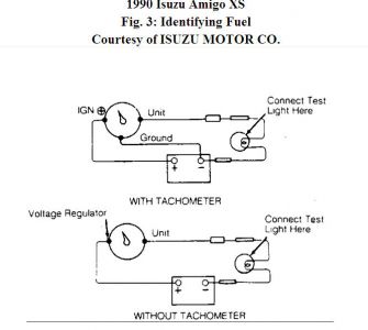

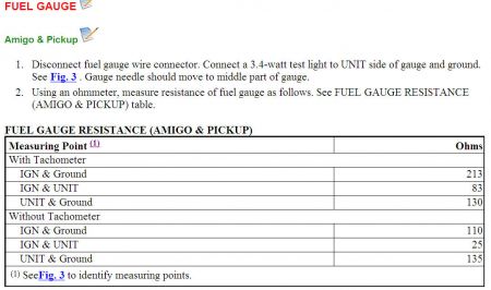

https://images.2carpros.com/forum/automotive_pictures/30961_amigo_1.jpg
https://images.2carpros.com/forum/automotive_pictures/30961_amigo3_1.jpg

Update: I saw the mechanic today and showed him your resources. I will be going back in a week when he will take the time to pull the unit and test more thoroughly. He said the same thing you did, he wanted to test it thoroughly before ordering another one or sending this one in for repair.
