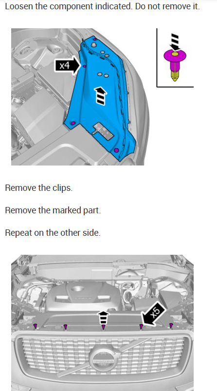

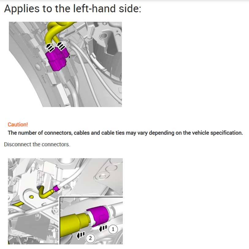

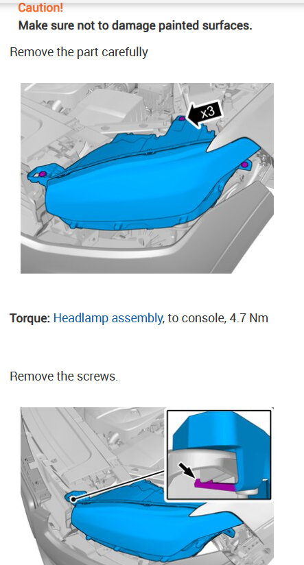

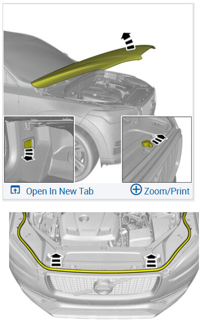

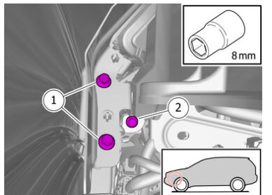

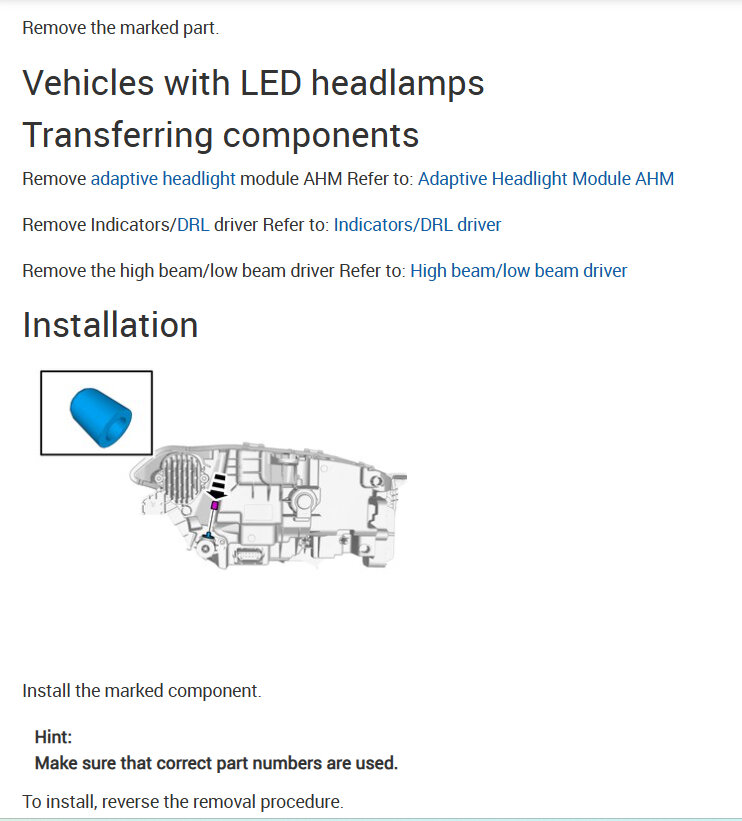

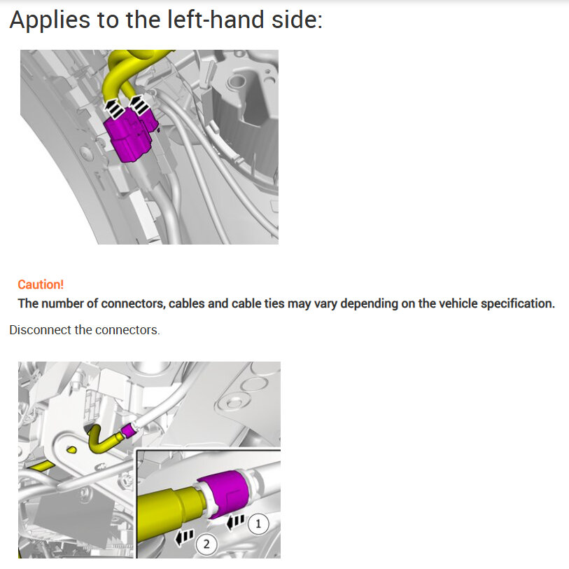

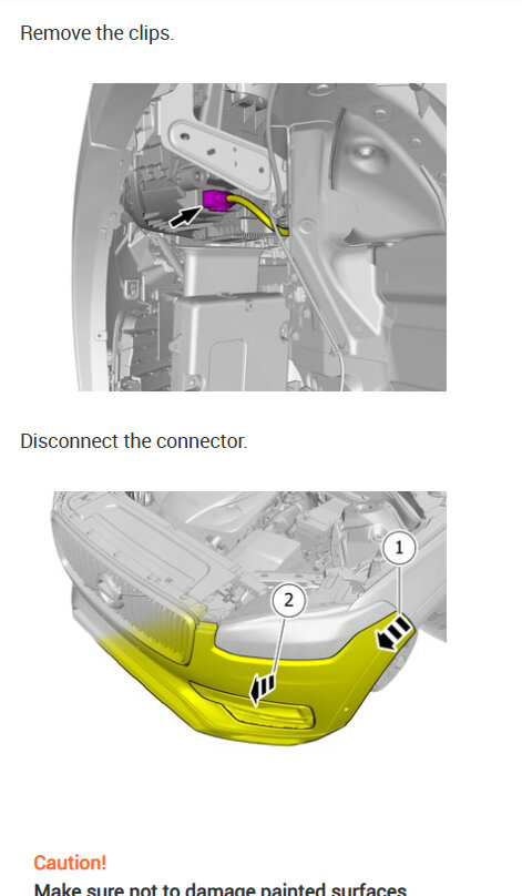

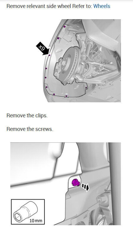

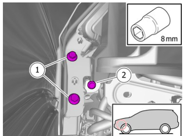

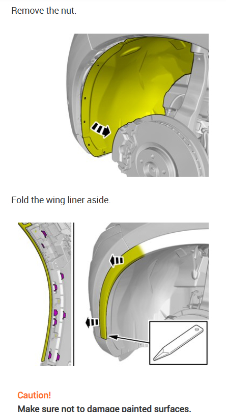

Make sure the blinkers have the OEM bulbs in them and not after market LED's this will make the system seems like there is a bulb out even though they are working. The headlight bulb service is a good one, you need to remove the inner fender well, upper and under valance on the left side of the car. Here is the instructions how to replace the headlight assembly. Check out the images (below). Let us know how it goes

ya am trying to figure out how to remove the blinker bulbs since they are regular ones and not LEDs, don't tell me bumper has to come off for that plz. I don't think low and high beams have any replaceable bulbs the whole assembly may need replacing
Jan 2, 2026 at 2:33 AM
  • 55,433 POSTS
Yep, you are correct on the entire headlamp housing assembly needing to be replaced. If you go over the instructions above you can see the front bumper cover will need to be pulled forward to remove the housing.

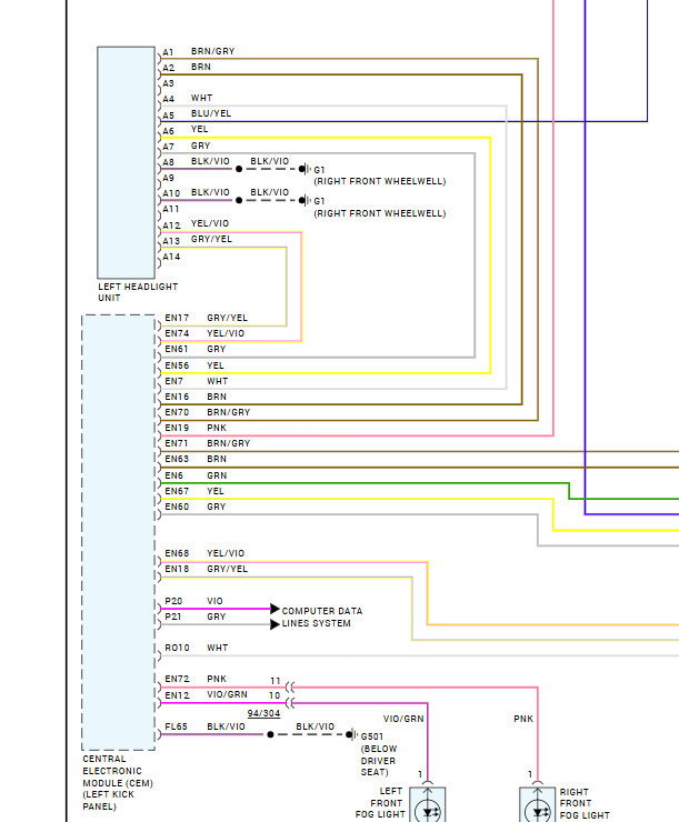

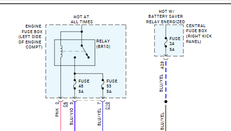

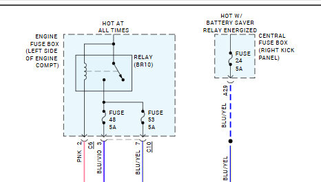

Yep, they don't care about the consumer, just the sales. There are three fuses that run the system, then it is just the CEM and the individual headlight units and wiring. You might want to check the grounds as well which are the blk/vio wires at the headlamp assembly. Here are the fuses and the wiring between the CEM and headlight unit so you car test them to confirm, this guide can help

Checked all fuses they are good. Next would be to remove the bumper slightly to get access to it. Hard to reach the wires

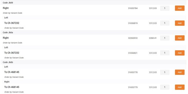

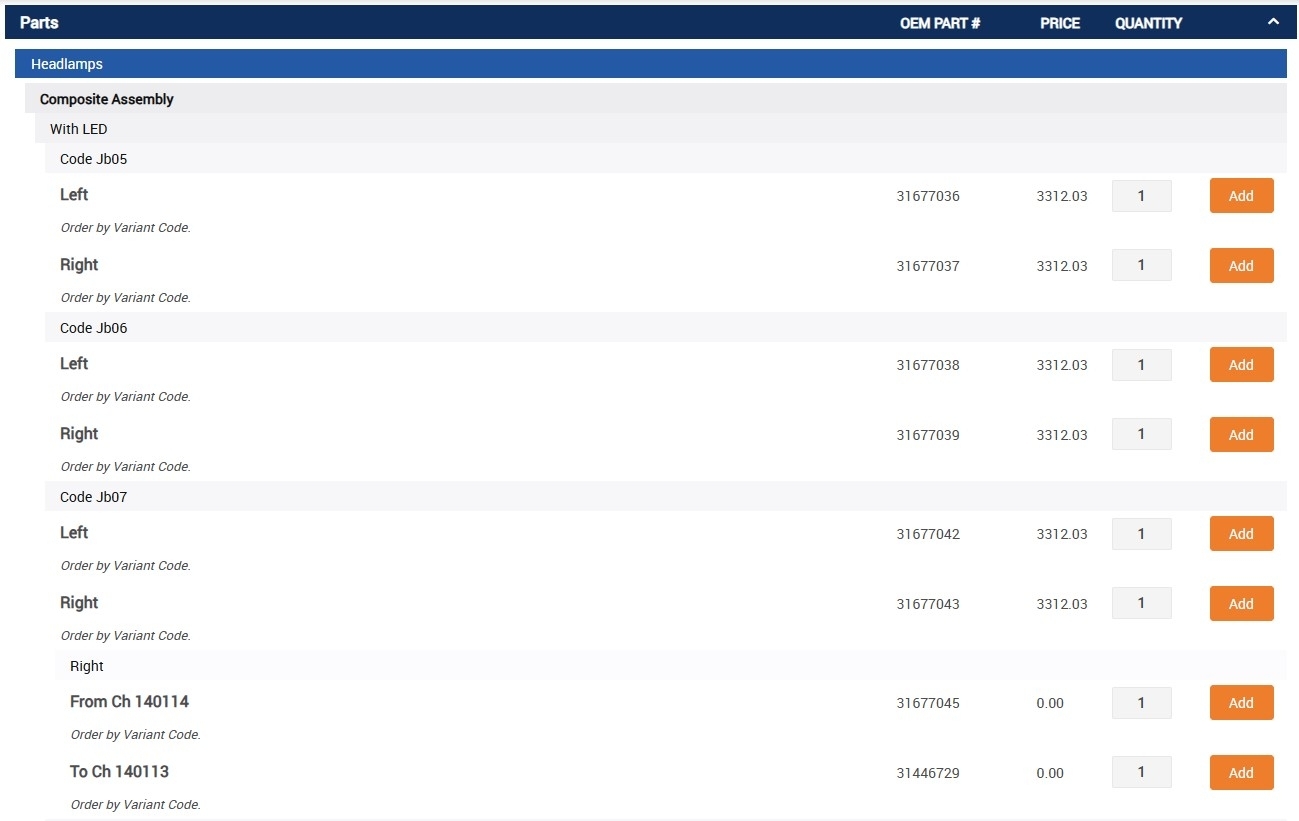

Run into that a lot with dealerships these days. You might want to go on https://www.car-part.com/ and see if you can find a yard that has one. It looks like there are 10 different variants for the lamp assembly, doesn't say what the difference is though. Not sure if the VIN might help with that, if they gave you the actual part number you needed you might try the auction site and see if there are any out there.

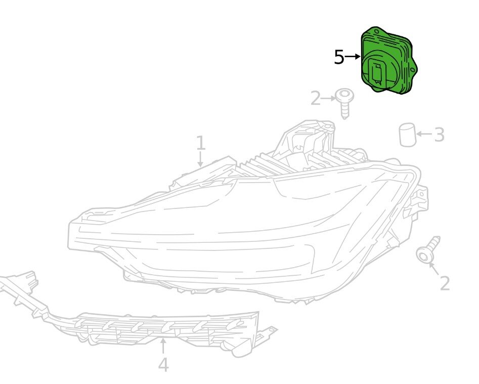

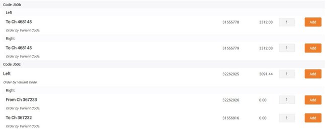

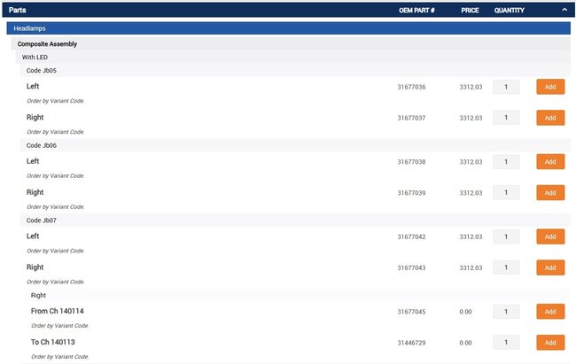

Can they tell you what variant is in it? The parts listing for that car shows different actual part numbers as shown in the attached, I suspect they do with different option packages or suppliers? Don't see many Volvos in my area. A couple look like they are build date based. I know some of the splits GM does with theirs are fun, they will use a module in one option that they don't in another but you cannot program a function in the vehicle without the module unless you install it, do the programming and then remove it. Really stupid system.
There is a headlamp control module that attaches to the rear of the light, That is the part that contains the control circuitry, That could be the problem part. Same part for both sides. # 31427776 as much of a pain as it would be, you could swap them and see if the failure follows the part.

Ya you are right. They gave me the part numbers. First one is for the assembly, the second and 3rd are the 2 modules on back of the car which are cheap. I could replace both but not sure if it will solve it. Here is what they gave me
Jan 8, 2026 at 11:37 PM
STEVE W.
  • 15,352 POSTS
Looking up the part numbers they show up as variant JB07 parts.
This is the control module -
Headlamp Drive unit. XC90. Headlamp. With led, to ch 344889, high/low beam, code jb07. Without cross county to ch 51345, with cross county to ch 27393, high/low beam, code jb07. Led control module. V90.
The ballast could also be the issue.
The modules should still be the same for each side. I'd probably swap them, if the issue is now on the opposite side you just need the single module. The parts need to come off for any replacement regardless, a few more minutes to be sure of the parts needed shouldn't be that bad. I don't show any programming needed in the service info, for just the module swap but I'm not sure I trust that. I doubt there is anything for the ballasts.
Jan 9, 2026 at 12:12 AM
