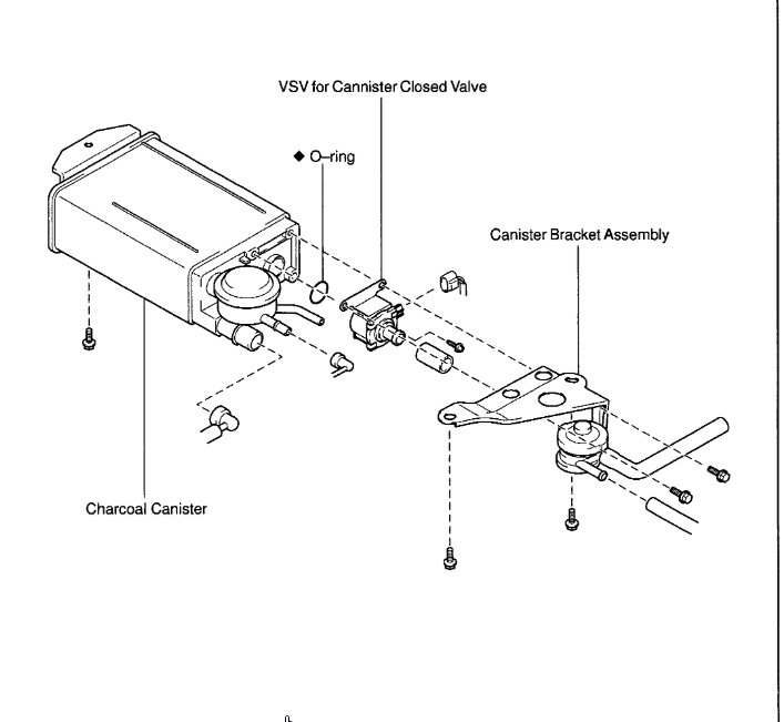

Okay, thanks again. That's most helpful. Now the engine itself seems to run okay with the exception of it trying to stall at idle at least twice in as many days here lately, once at a traffic light and once sitting in a parking lot. Would I be able to take this car somewhere and have the purge valve tested? I don't currently own an ohmmeter. Also where is the canister?
Oct 4, 2019 at 11:49 AM
That makes sense. Stalling is a sign of a purge valve. The canister is located under the vehicle back by the fuel tank. I could not find a location to be able to show you exactly where but here is the picture of it. It should be close to the fuel tank because it is where the vapor from the tank is held until the purge pulls it into the engine.
