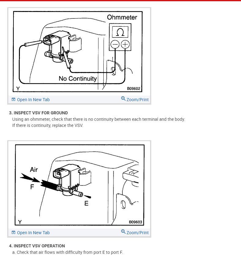

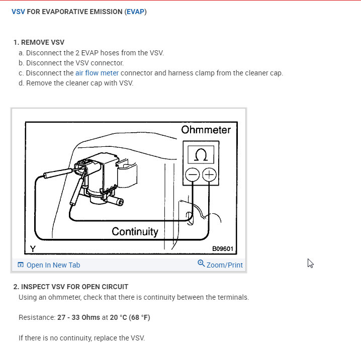

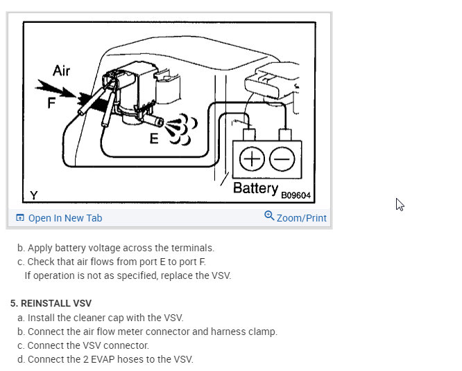

This sounds like you have fuel in the emission system. I would suggest testing the purge valve to see if it has failed.
You could also just have a fuel leak. Have you ever found any fluid on the ground?
The way this works is the fuel vapor from the fuel tank goes into the canister where the purge valve pulls it into the engine to improve fuel mileage and reduce emissions. If this is stuck, it can effect both and produce a smell.
Let me know if you have questions but lets test this first and then go from there.

Okay. If no fuel on the ground then the canister is most likely where the smell is coming from. As for the noise, it could make a noise. It is a valve with an electric actuator/motor on it. I have not heard any of them make a noise but again, it is possible. Normally the purge is not active at start up but it could be going through a self test. If it is now stuck open it wouldn't make the noise anymore. However, when they stick open they normally make the engine run rough but it is not a guarantee.

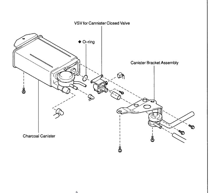

Okay, thanks again. That's most helpful. Now the engine itself seems to run okay with the exception of it trying to stall at idle at least twice in as many days here lately, once at a traffic light and once sitting in a parking lot. Would I be able to take this car somewhere and have the purge valve tested? I don't currently own an ohmmeter. Also where is the canister?
Oct 4, 2019 at 11:49 AM
That makes sense. Stalling is a sign of a purge valve. The canister is located under the vehicle back by the fuel tank. I could not find a location to be able to show you exactly where but here is the picture of it. It should be close to the fuel tank because it is where the vapor from the tank is held until the purge pulls it into the engine.
